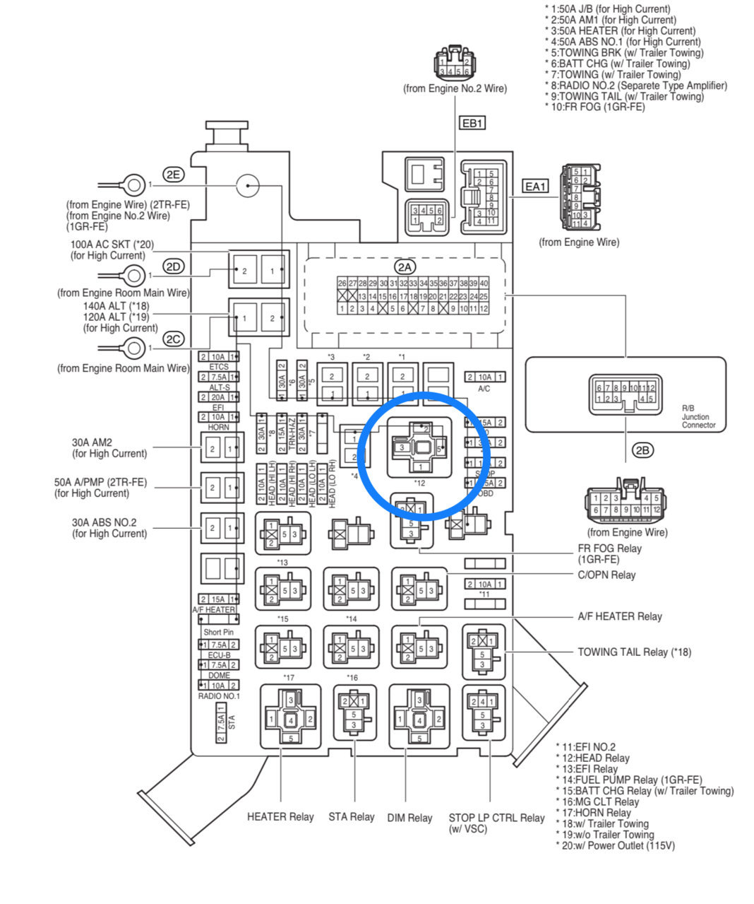

    first post so sorry here. I was doing something funky (wrong) and jumped the bottom and right legs of my headlight relay together. (if you are standing on the drivers side looking at the relay box) this seems to have shorted something out. i can jump the top leg and left leg together and make my headlights come on, but i am unable to switch my headlights on and off like normal. i replaced the relay and the issue still persists. i know what i did wrong but i do not know what else is ran in conjunction with this relay that i could have blown. again, i can jump the relay out and everything comes on and there is no blown fuses. HELP PLEASE!?

    The dimmer relay sounds like the issue based on your description. What other relay did you replace?

    I only replaced the headlight relay, I didn’t know untill now that it was also wired to the dimmer relay

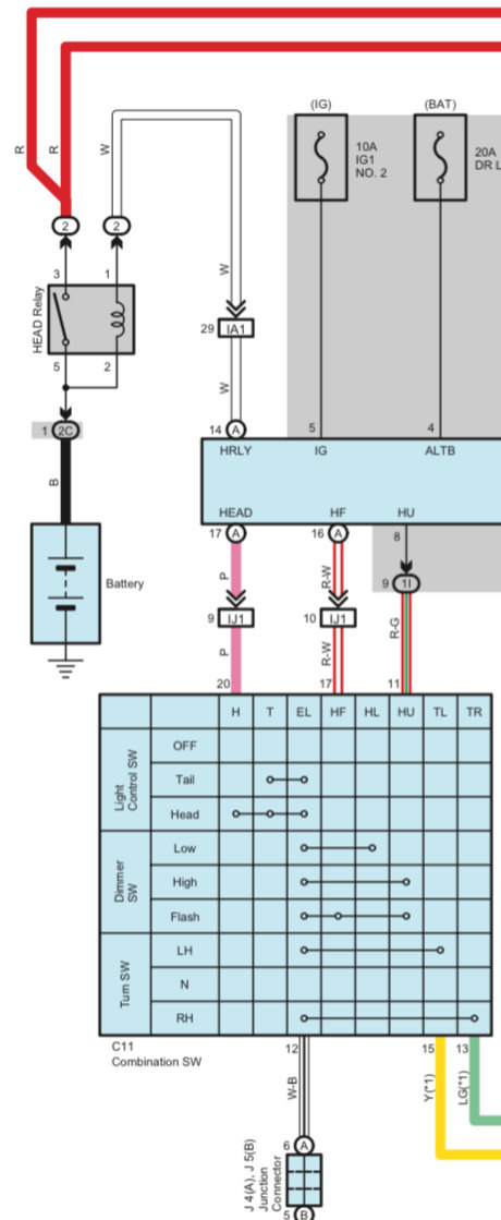

    Can you tell us what numbers you jumped together?
  9. Mar 28, 2022 at 12:26 PM
    Jcatty10
    Jcatty10 [OP] Member
    Mar 28, 2022
    #393668
    8
    2013 tacoma pre-runner
    It was 5 and 1
  10. Mar 28, 2022 at 12:35 PM
    TnShooter
    TnShooter The TacomaWorld Stray
    Sep 2, 2010
    #42625
    20,865
    Deogee
    07' TRD Off-Road, Auto
    STOCK
    It looks like you sent 12v to the control side (ground) of the ECU.
    That’s not good. Someone like @Dm93 might have an idea of what could have been damaged?
    I suppose there’s a small possibility the head light switch is bad, but I doubt it.

    If you wanted you might be able to test to see if the ECM is working.
    You could probably test this at pin #1 of the relay to see if it’s getting a ground signal.
    But I’d feel much better letting one of the other guys that do this daily, tell you the best way to check it.
    Hang out a bit, someone smarter than me will drop in soon.

    OP, you sent unfused juice to the ECM, so most likely it fried the trace.

    Something to add which I know is not good but maybe can tell y’all more info. I am getting like 3 volts on my #1 connection which from my understanding is supposed to be 0v lol. So I’m assuming I’ve fried that input. Is there anything I can do to remedy this without getting a new ecm?

    I’m sure you could rig something up like another switch to control the relay. But I wouldn’t recommend it.

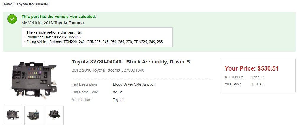

    Yea unfortunately you likely fried the driver in the body ECU for the headlight relay if you turned the light switch on with the terminals jumped together.
    Not sure what the cost on one is, it is on the back of the interior fuse box you will have to get the part number off it and see.
    I'd imagine you could find one in a salvage yard for a reasonable price.

  18. Mar 28, 2022 at 4:48 PM
    #18
    Jcatty10
    Mar 28, 2022
    #393668
    8
    I went ahead and ordered the dimmer relay to try my luck, I’ll update y’all with how dumb I turn out tomorrow

  20. Mar 28, 2022 at 6:33 PM
    #20
    Dm93
    Dm93 Test Don't Guess
    Mar 3, 2015
    #150066
    12,715
    Texas
    2014 DC OR 6spd 4x4
    Predator tube steps, Ranch Hand grill guard, Magnaflow CatBack exhaust, Toyota tool box & bed mat, 2LO Module by @Up2NoGood, Rearview Compass/Temp Mirror, Tune by @JustDSM.
    :eek: Yea I would be calling some salvage yards before I paid that much for a new one.
