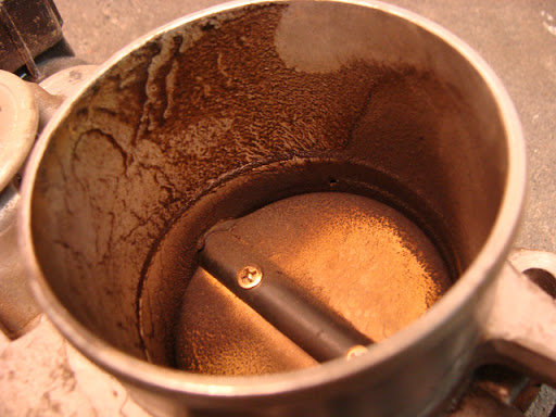

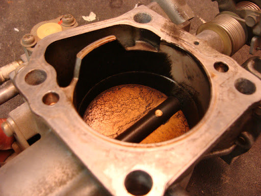

    Just stumbled on this thread... Sub'd.
    I've been running a K&N since I bought my truck back in '01.
    With about 178k miles on the clock, I pulled my throttle body about a month ago.
    Here's what I found:

    I agree the oil could be condensed from oil vapor backing up from the PCV. But that's not all I'm seeing... by the lack of sheen it appears a fine dust is embedded in the oil streaks.
    If so, dust a filter should not have let by perhaps? Is this the first time you've had the TB off or cleaned?
    The times I've had a TB apart... admittedly with a lot fewer than 178K... the oil film was tacky and had a sheen. It was obviously only cooked on oil, with no or discernable dust in it. And that vehicle did a lot of desert cruising!
