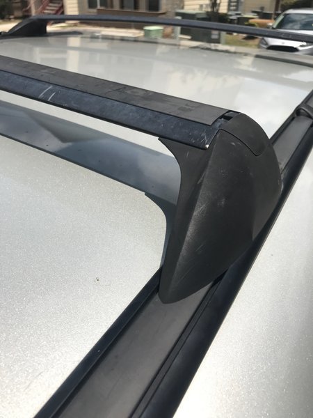

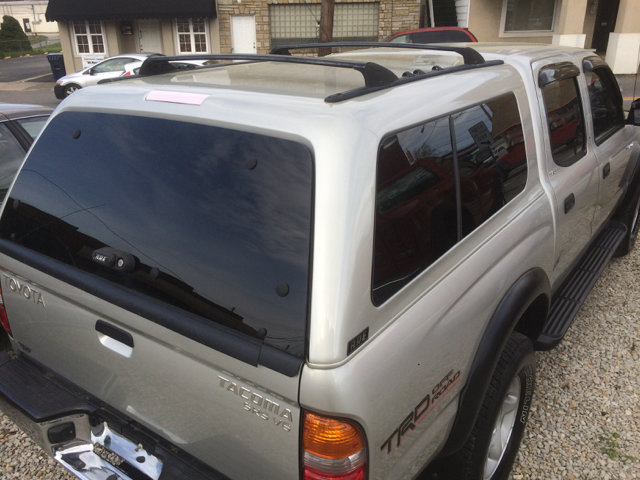

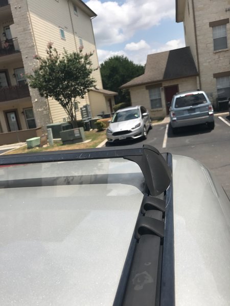

    Considering buying a kayak in the future and was wondering if the roof rack that came with my ARE shell could transport a kayak. Brand is nomadic, not sure what model. And if not, how much trouble would it be to remove and add something like a yakima rack?

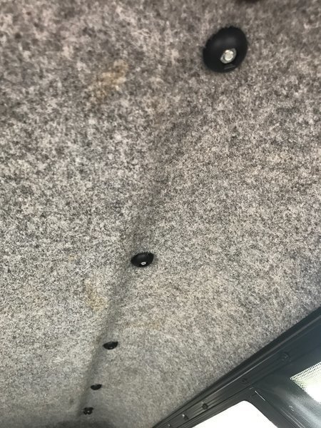

    How are the rails mounted, i'm sure the racks could hold the weight, but the up draft from your kayak catching the wind might pull the rails off if they are not bolts with backing plates. I have a Thule rack on my shell and it held my RTT no problem.

    Not sure if this helps

    Look inside the shell, do you see screws, bolts, Etc.. sticking through the inside? It looks like it will hold the weight of a kayak, what are they 50-70ibs, but when it catches wind and pulls up could be a problem. Or run a line from the front bumper to the bow, and a line from the rear bumper to the stern to hold it down.

    I would guess that would hold a kayak no problem but not sure where you would tie it down.

    Looks good

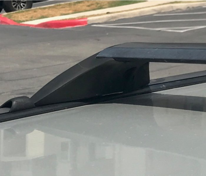

    Any chance you know if the yakima saddles/rollers would fit on my rack or are they specifically made for yakima racks?

    maybe add a roof rack for the truck as well for extra security and as well as another posted tie down to the front and rear bumper if possible
    id say yeah yes the racks will take the weight of the kayak the only issue is the up wind

    The Yakima Deckhand and Handroll will fit pretty much any rack, including aero style like yours. If you wanna get fancy, the Showdown should also fit.
    You should be good to go. Just be sure to tie down the bow and stern while in transit.
