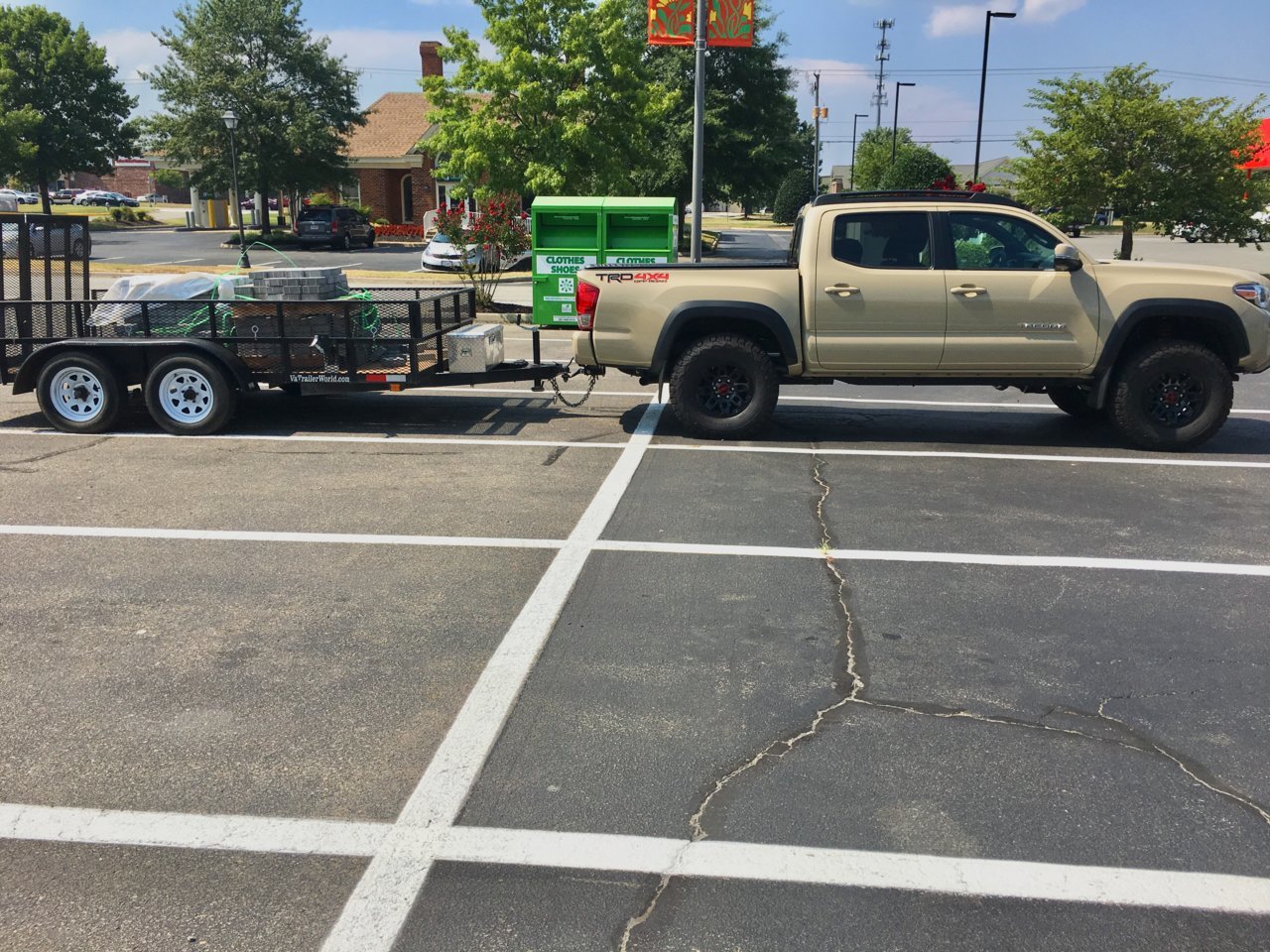

    That was 5,500 lbs, pull it for about 35 miles...it pulled it but it wasn’t easy on the truck, coming to a stop was sketchy at times, it struggled big time at take off once it got up to speed it wasn’t too bad but I def would not want to be pulling that kind of weight on a long haul...need a full size for all that

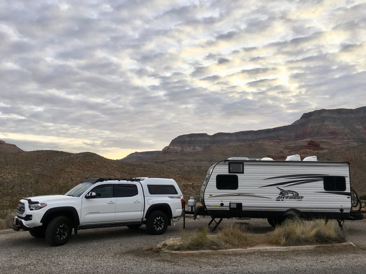

    We have a smaller Jayco (175rd @ 3000lbs) that our 2017 V6 Taco pulls just fine.
