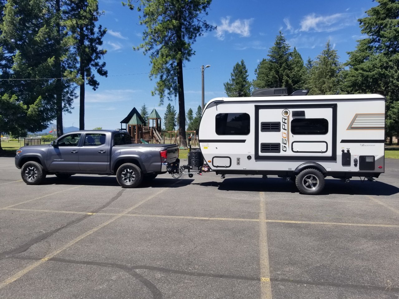

    This is our setup. She's not happy on the highway. 4 th gear at about 4500 rpm with my cruise control set at 60mph. I'm not trying to ring it's neck. It'll do it just fine around town and shorter, more local trips. We got 11mpg with the wind from North Idaho to Leavenworth, Wa., and 9.5mpg indicated on the return trip which was against the wind.
    To be transparent, we are SUPER happy with both the truck and the trailer! However, I might have expected too much from the truck based on ALL my previous towing experiences being with full sized trucks with mostly diesel engines, and an occasional big gas V8.
    Truck: 2018 DCSB OR A/T
    Trailer: 2019 Rockwood GeoPro G16BH (2916 lbs dry, about 3200 lbs set for camping, but with all empty tanks... get water at or near destination).

    Both sound great!! Steep grades, windy turns and low clearance campgrounds in the redwoods. Soft sand and lots of wind in the desert. Definitely get something smaller!

    That’s about like mine, sans slideout. 4th gear is typical. Towed it at 65mph in Utah’s 80mph zones... did well, even when the tripled trailer semi’s went by and in heavy crosswinds. I have a combo weight distribution/anti-sway hitch, and our trucks have the vehicle stability mode too, but mine never even came on.

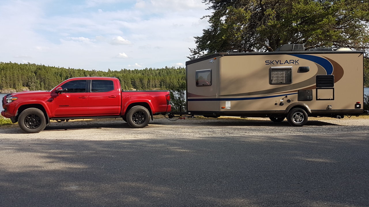

    I tow something similar in weight but at around 21'. Could you even imagine towing what the OP is looking at?

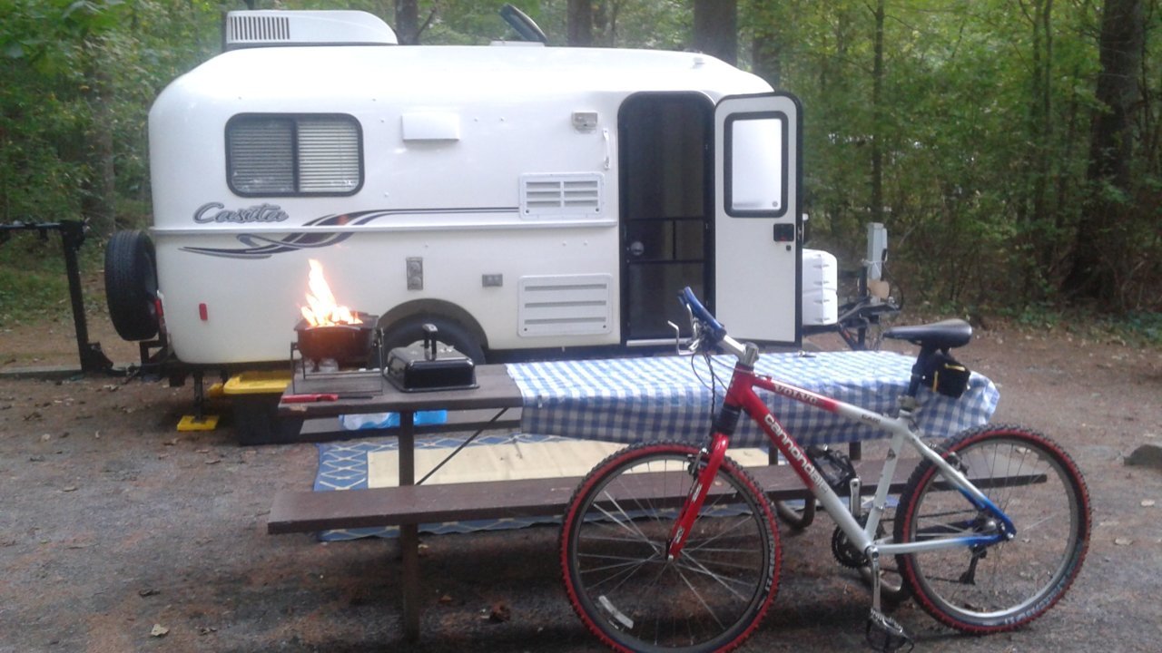

    I bought a lightweight fiberglass camper. My 1st gen Tacoma tows it with ease.
    JmsWms, Green Jeans, Sharpish and 2 others like this.

    I have a similar trailer, but much older. Fibreglass 17'. It tows well but I have to keep it in 4th and rev it.
    I couldn't imagine trying to tow something like the OP asked about. Would the truck survive? I think so. But it would be a tiring and stressful experience.
    Some of the posters quoting max ratings and arguing that it's totally doable obviously live somewhere very flat with no traffic. Try getting cut off descending a twisting mountain pass 4 hours into a road trip with a stiff cross wind in the rain with your max load pushing you and yanking you sideways. You'll have a max load in your drawers.
