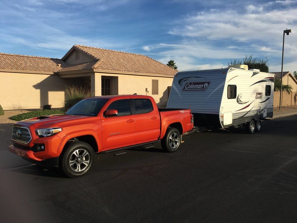

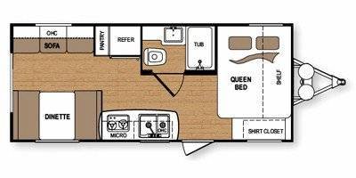

    We have a CTS192RD that weighs 4,300 pounds dry. Towed it the first time with a 14 Tacoma OR and hated pulling it. Drove straight back and traded for a 14 Tundra and while it towed better, we did not like it as a daily driver. Traded for a 16 Tacoma and it towed much better than the 14. We are now towing it with an 18 Tacoma OR 4x4.
    We do not do a lot of towing with the Tacoma and it is just a better truck for us most of the time. I just drop it in 4th, hit the ect button. We have a good weight distribution hitch, Tekonsha brake controller, are very careful about how much weight we carry and how we load the truck, and never travel long distances with anything in any of the tanks.
    The truck struggles at times, but nothing it cant handle. On big hills she does just fine and will go way faster than what I want to go. I just get in the right hand lane with the big rigs and take our time.
    Most importantly, your tow vehicle and RV need to be maintained. Tires are crucial. The Chinese trailer tires on most RVs are shit. I wouldn't drive around the block with them even if they were brand new. The first thing you should do is remove the tires and put on some good tires like these https://www.goodyear.com/en-US/tires/endurance.
    I see people towing trailers all the time going faster than 65mph with tires that are only rated to 65mph in temperatures well above 100 degrees and driving like they don't have a trailer behind them. Use common sense and slow down making sure to leave enough space between you and the car in front of you. And make sure you get some good tow mirrors. I see people driving Tacomas and 4Runners towing camping trailers without any tow mirrors and there is no way you can do this safely without a camera. You cannot see who is behind you.
    Take a look at the CTS192RD (or other manufacturers model of this floorplan). It has worked well for us and offers a lot for a small trailer. Plus, they are super cheap.
