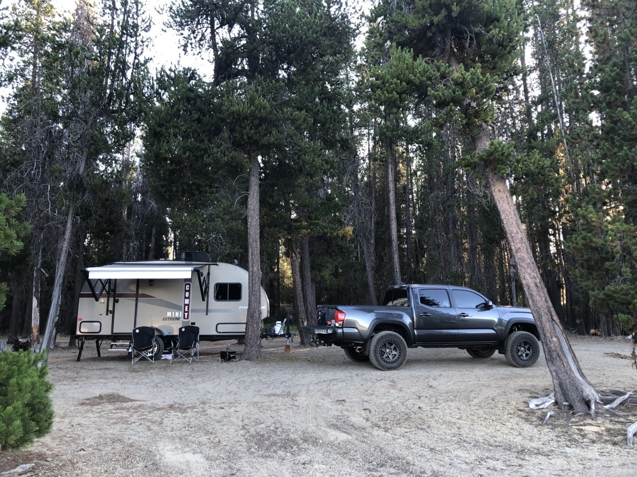

    #93
    Max713
    Max713 Well-Known Member
    Nov 29, 2013
    #117569
    629
    Max
    Eugene, OR
    2017 MGM TRD OR
    I've got a 2017 TRD OR.
    Stage 4 Icon, progressive AAL in the back.
    OVtuned.
    285/70r17 tires.
    Our camp trailer is just over 3000lbs empty, probably close to 3500 full of water and camping gear. Truck tows it just fine, even over the Willamette pass in Oregon, which climbs over 5000ft.
    4th gear on flats, 3rd gear on any kind of hill, only hit 2nd gear on the steepest sections of the pass. Average's between 9 and 11 mpg.
    I need to upgrade to the full RXT leaf pack, but other than that I'm happy.
    You should be able to tow your boat not problem, but you will need a brake controller and something to help out the rear end sag. Ideally a new leaf pack.
