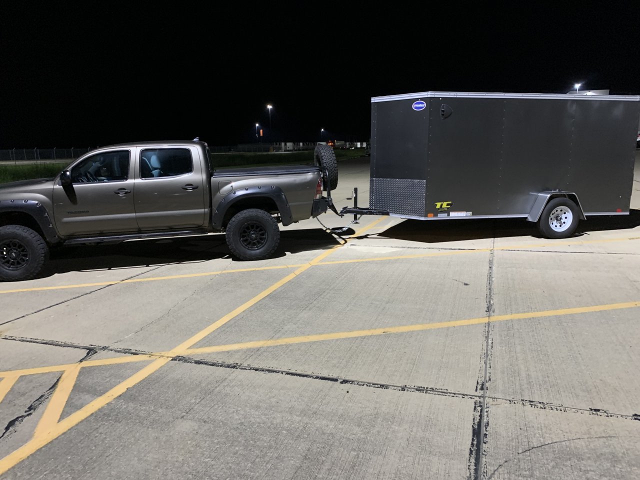

    My wife got a Hemi yesterday because I can’t do this any faster than 55 and no AC without getting hot. Only two quads in the trailer

    Really. Something seriously wrong with that truck if you can't go over 55 or run the a/c towing that. What's it weigh with the quads in it. A tacoma is far from an ideal tow vehicle but should tow that easily. Unless that trailer is heavier then it looks.

    About 3600 lbs with the quads in it. I have a winch bumper and I think/hope it might be blocking too much air.

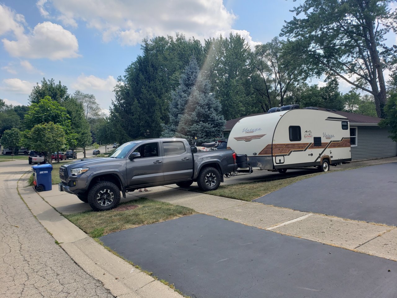

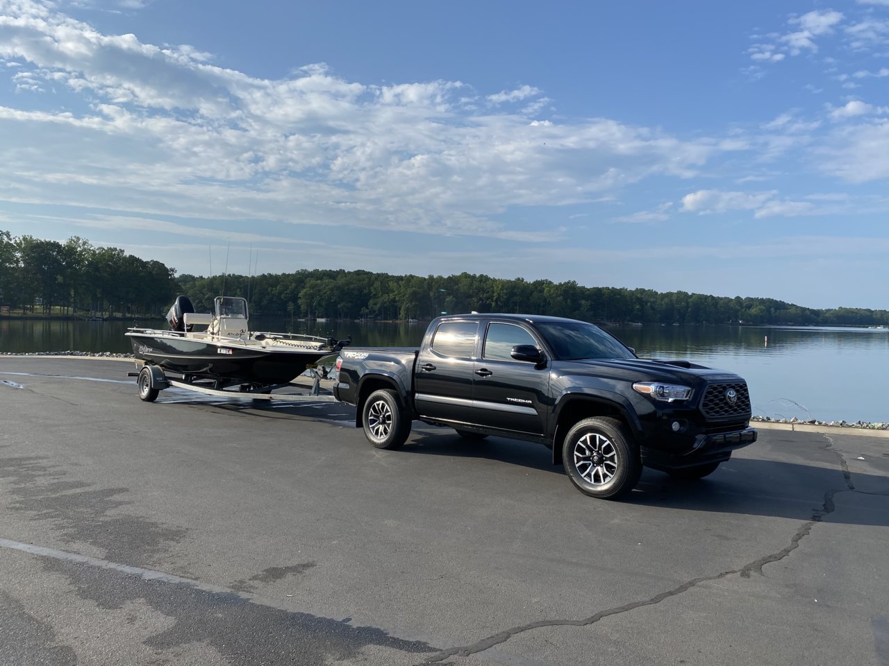

    This is my usual tow.... it’s about 3200 when fully loaded (fuel, ice, gear, etc.). My Tacoma has zero problems pulling it and I do use ECT. My only concern is braking since I don’t have trailer brakes but it’s not too bad. 8BF2401D-A112-4F4E-871B-2ECCAA9AE07E.jpg

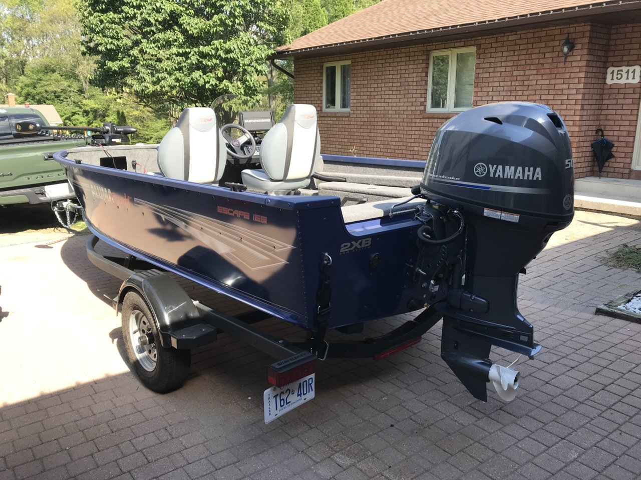

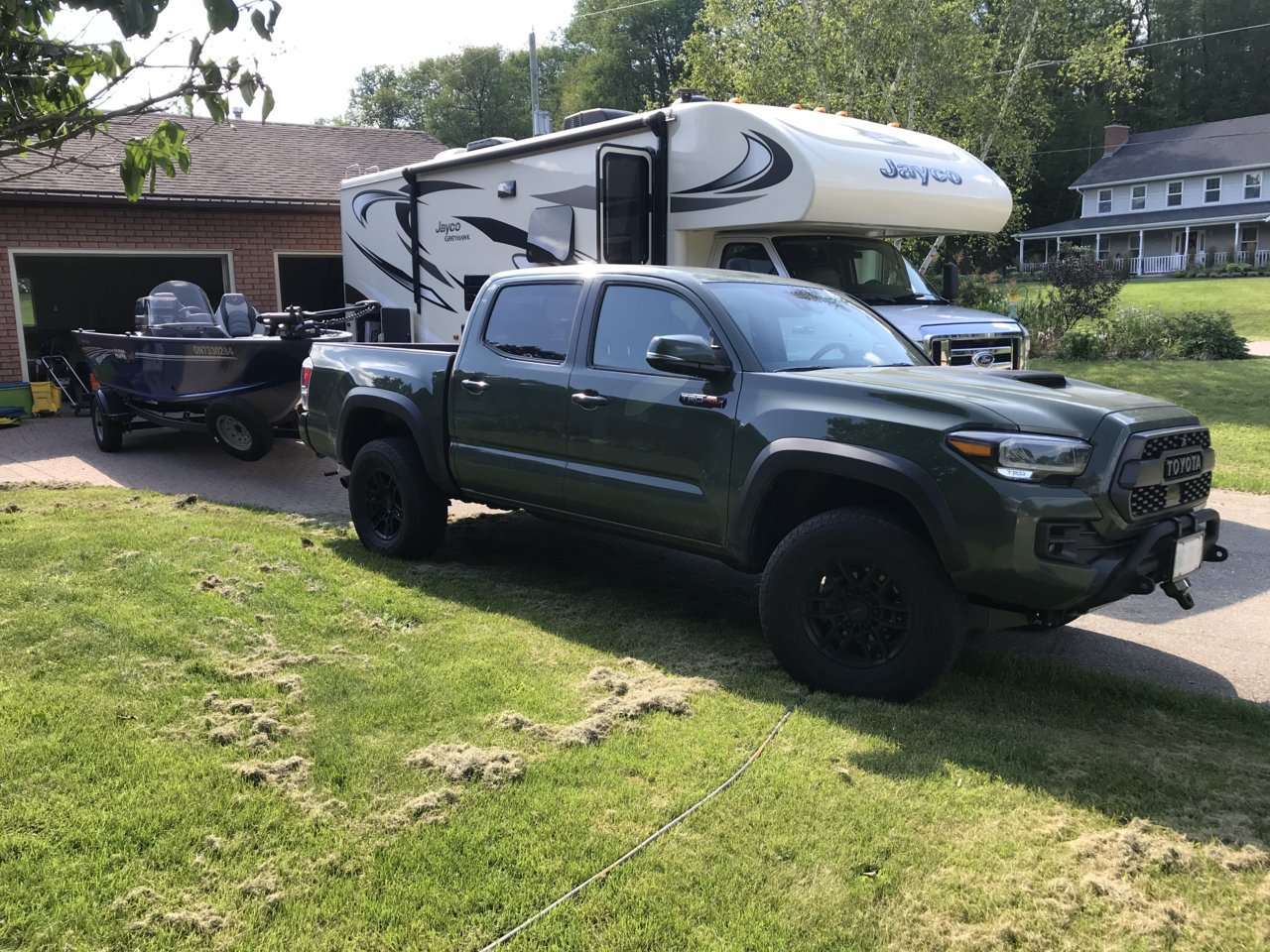

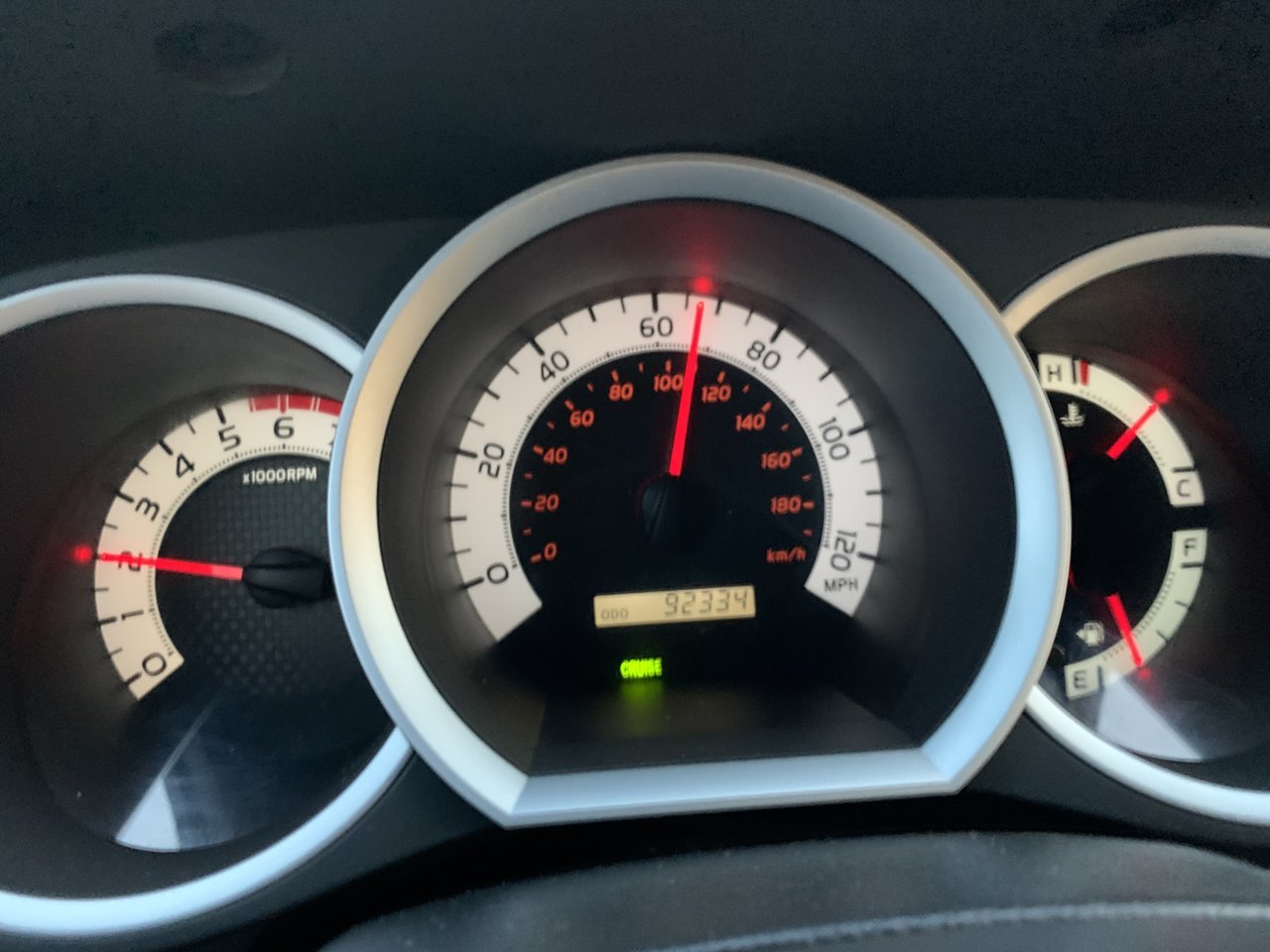

    You were right.
    I re-washed the mud off of my radiator and had it flushed. BE3C7864-C8B1-458F-8904-975F2BF8D2FD.jpg

    Bigger tires are lowering his engine speed and the lift and accessories are increasing drag and adding weight. Not sure if the OP mentioned, but if towing in 5th gear and AC on is extra load and gearing disadvantage.

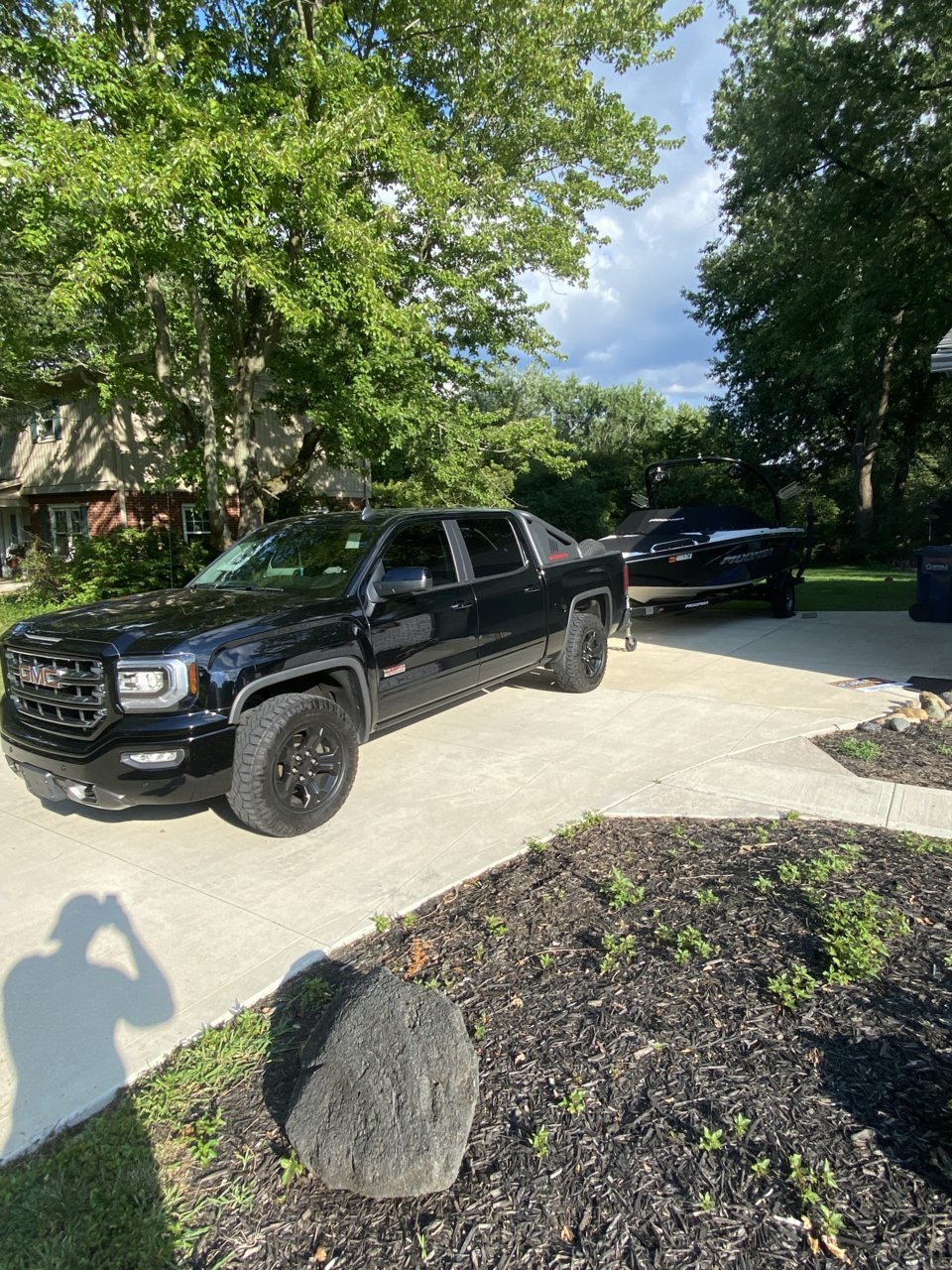

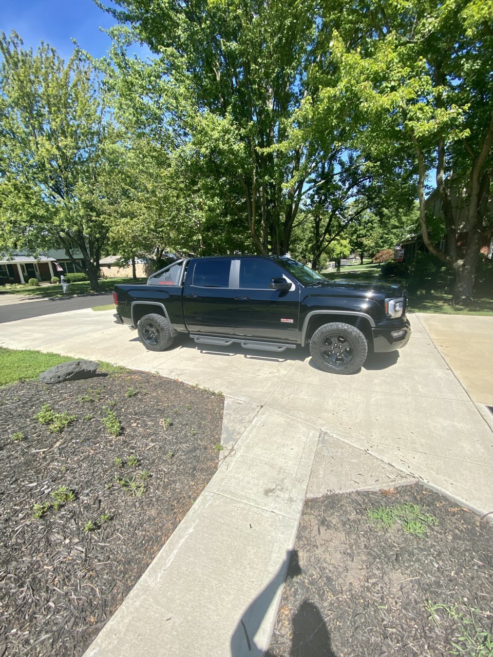

    Here’s the new rig and boat! Definitely a night and day difference in stability and gets about 5-6mpg more than the Taco did. While I do miss my Tacoma this truck was well worth it and probably the nicest vehicle I’ve ever owned. Now the question is how long can I wait till I either slap an Icon stage 3 or dirt king set up on it haha. Told my wife I wasn’t doing anything to it for at least a year and it’s Already going in next week for undercoating
