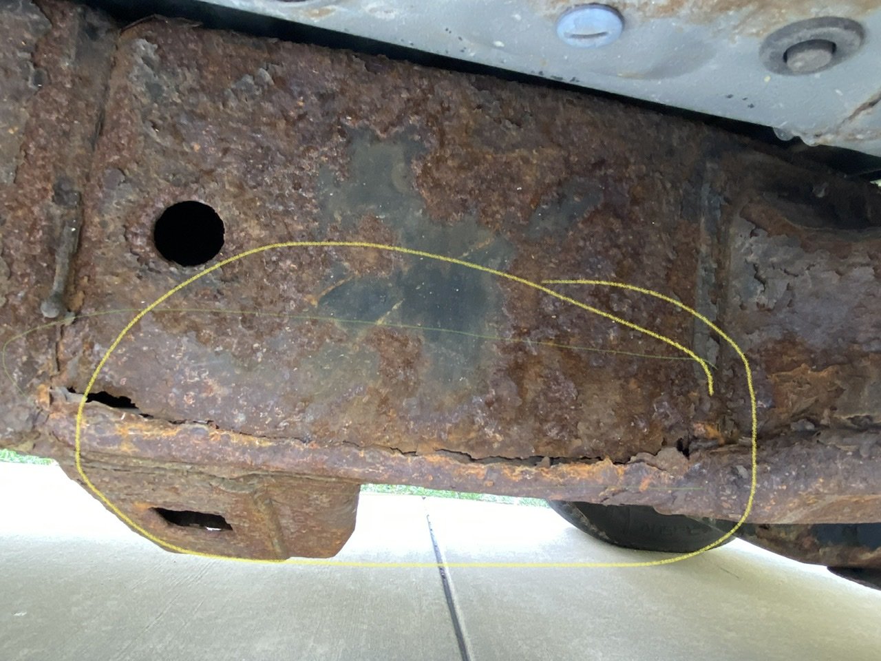

    I just noticed this crack in my frame and I would not be surprised if it happened while transporting the full load of dry sandy topsoil.don’t make the same mistake!

    LOL. The problem with your frame is that rust ate a hole in it.
