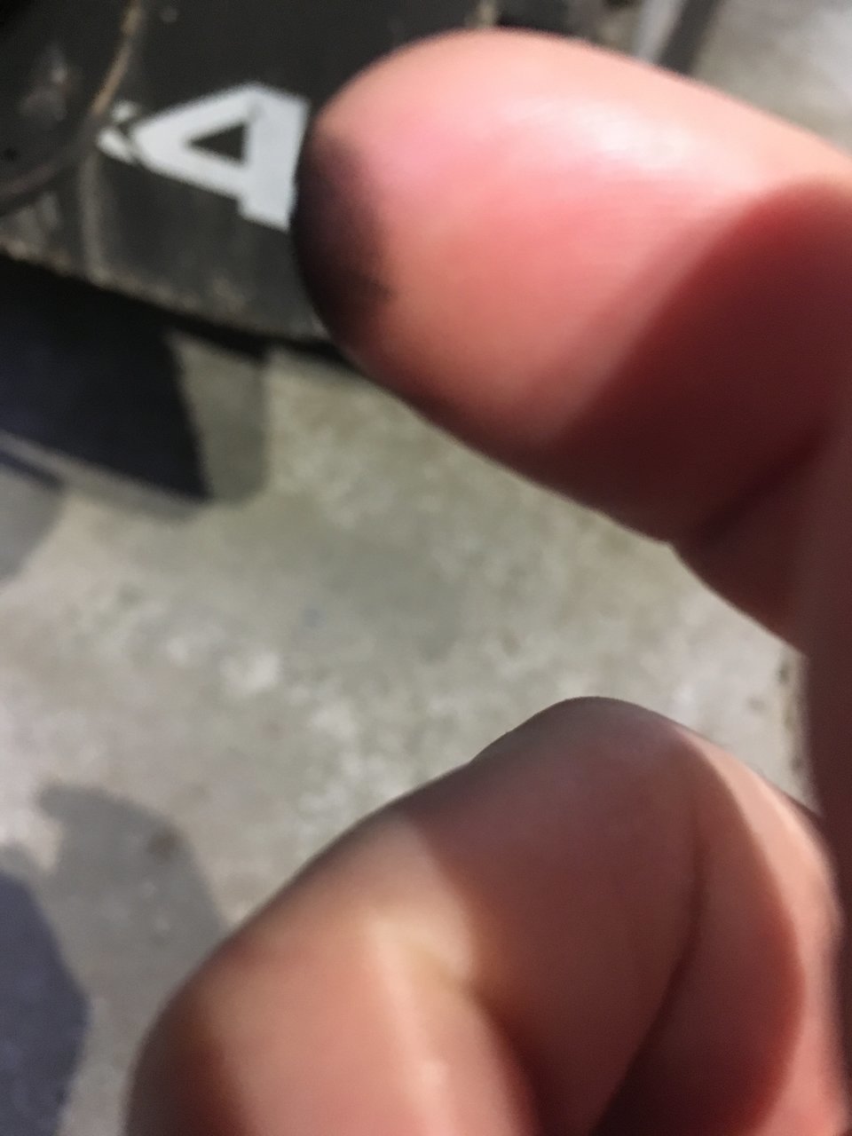

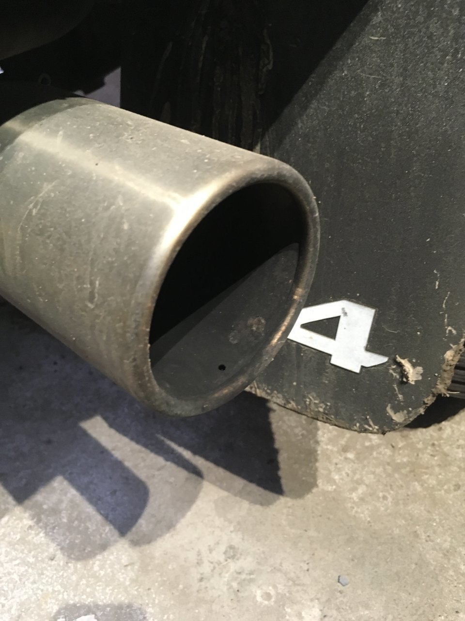

    Mines been black since I got it at 95,000, it’s even made my fender flare become permanently stain black. Any way to lean them out, like getting an aftermarket ecu? Just curious

    I have heard of this before on TW, and it doesn't sound like there is a fix... Just a characteristic of the engine. I can deal with this as long as it is not a fatal flaw of the engine, which it sounds like it is not. I have seen many people surpassing 200,000 miles with no issues. My oil consumption is what concerned me to begin with, and the reason I started this thread. I just happened to notice this morning how black the exhaust tip was inside. I guess 1/2 quart in 5,000 miles isn't terrible, it is just not what I expected. Oh well, if I get 250,000 miles then I am happy. Unfortunately, this all started after my warranty expired. Then again, maybe it is a blessing because I don't want anyone tearing into my engine at 55,000 miles.

    Exhaust tip is clean..
    Is it possible that you may have a diffeent EPA blend of fuel.
    I'm in Connecticut.
    I also use Pennzoil Platinum 5/30..Mainly use Citgo fuel. Sometimes Sunoco sometimes Shell.

    Mine’s golden black - I may buy one of Toyota’s tips to hide it, but it’s just another thing to clean if I do...

    I had so much it was leaving stains from the tip to the bumper on rear bedside so i chopped it at axle

    Nice and sooty. Before i put a down turn (and later chopped before axle), it would spray black crap on the garage wall on start up. Dang thing runs rich in the cold. About 1/3 qt oil consumption with every oil change.
    Go out every now and then on the highway and give it a WOT run (think merging from a rolling start).

    274k and mine has a light knock on cold start up, I've had several Toyotas that do this, is common and a non issue.
    and yes, there is soot in the tail pipe, not heavy, but there. Most of it comes from cold start up, the catalyst isn't hot enough to burn off the excess fuel needed for cold start, so there is always a small amount of soot/unburnt fuel

    My truck had a clean tip when I bought it. I started to notice the soot after I put a header on. Added a supercharger and cleaned it, and it’s back to sooty.

    This is not a fuel issue. I only use Costco gas, run Lucas fuel system cleaner through it every 5k and use Amsoil so that's about the best you can do. The 4.0 just runs rich.
