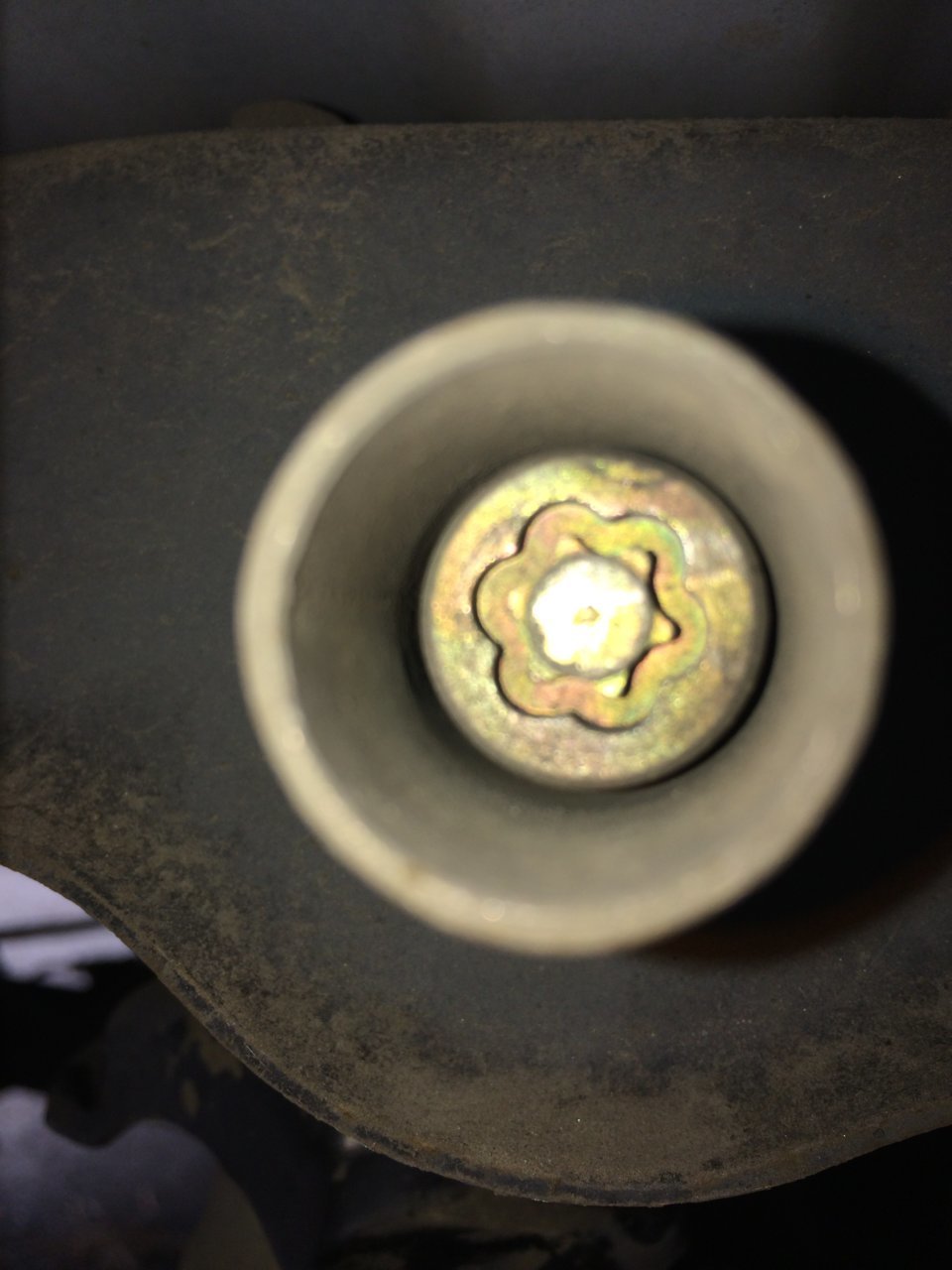

    CC390710-05C0-44B1-AD3A-29B0F0A695B4.jpg 719A7A44-873C-4FF1-A440-4B6A05B1D41C.jpg FFA484F1-851E-4126-9DB0-9ACA00CB1123.jpg 9E66B4E1-DBF1-4BCB-992A-AC41227D5F54.jpg I bought this truck last year and would like to finally put the spare where it should actually go rather than just in the bed. For the life of me I can't find the right "key" to fit this star pattern. It looks aftermarket since the stock ones I've seen is just a slot. Any help or advice would help and be much appreciated!

    Looks identical to the lock on my 97. I couldn't get it off. Cut the cable to drop the factory spare, found a usable hanger at the local pick n pull and will have to pull my bed at some point to swap them.

    I called around, nobody seemed to know what I was talking about. Hope you find one though, that'd be the better way to go

    Knock it off with a hammer and you'll have a plain slotted one underneath.

    Check with your local Toyota Dealer and see if they have a master key set for the spare tire lock. I believe McGuard makes it for Toyota as well as the wheel locks. I know that we have one some where at the Dealer that I work at.
    We hardly sell these locks because customers keep loosing the key. These lock kits are around $50.00.

    I'll give that a go before I take a hammer to it, hopefully they can take it off if they have the key. So much trouble for such a simple task. Thanks you for the info.

    Check with parts or service, one of those departments should have a master key set floating around. Good luck with it.

    I removed the mount completely on my DC and then took the locking portion off. I realized that I could have left it on and knocked it off while on the vehicle with a hammer and long screwdriver.
