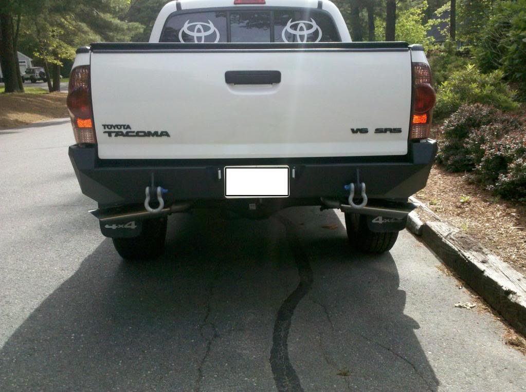

    Its a single in single out aero turbine 2525 run to duals by a local muffler shop, they made all the piping.
    Id look into the muffler i have then. Go on youtube and search for different sound clips of exhausts for your truck. Make sure use some good headphones to get an idea what it will sound like. Obviously the best way to tell though is by hearing it in person.

    I already said in a previous post, but it was around 450 total. I bought the muffler and brought it to a custom exhaust place and they installed it and bent all the piping and installed the tips.
