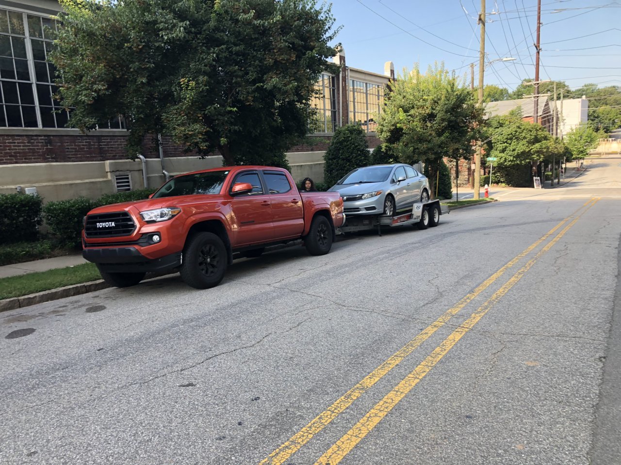

    When I had my 2.7L, before selling it and buying the 3.5L, I towed cross country a few times and faired alright. You should be fine.
    Took this through the West Virginia Turnpike without any issues at all.
    On hills just stay in the slow lane. Even if there is a semi going slow in front of you don’t even think about it. Leave early enough to give yourself time to get where you need to be.
