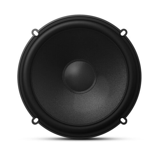

    I have some kappa 6x9 3-way components in the front that sound amazing. So good that I got rid of my sub. They are on a 125w x4 RMS amp.
    My rear speakers are another story. They are 60csx. The bass response falls off around 200Hz. The stock non-jbl speakers by comparison, had wayyyy better bass on a 125w amp. https://my.infinityspeakers.com/KAPPA+60CSX_.html
    VAS: 7.45L
    QTS: 0.77
    QMS: 8.39
    QES: 0.85
    FS: 78
    CMS: 301

    My first guess would be to make sure there’s not a hi-pass filter set on the amp.
    another little test is to swap your front and rear inputs on the amp. If everything still sounds the same, at least you know it’s not an amp issue.

    the last test i would run would be to swap the polarity of one of the rear speakers at the amp. it's possible one of them is wired reversed, which would cancel out the rear bass frequencies the most. though that said, the rear locations really suck for acoustics, so a lot of it just how they are.
