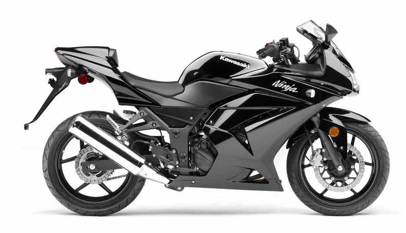

    This is a 250cc kawasak ninja. It weighs about 300lbs and produces about 30hp.
    Kawasaki%20Ninja%20250R%2008%20%204_zpsy_8f18936640076d3e715f88ab505c3f4c183c3f58.jpg
    So let's hook up our hypothetical 10k lb trailer to it.
    30hp/10300lbs, ptwr= .002.

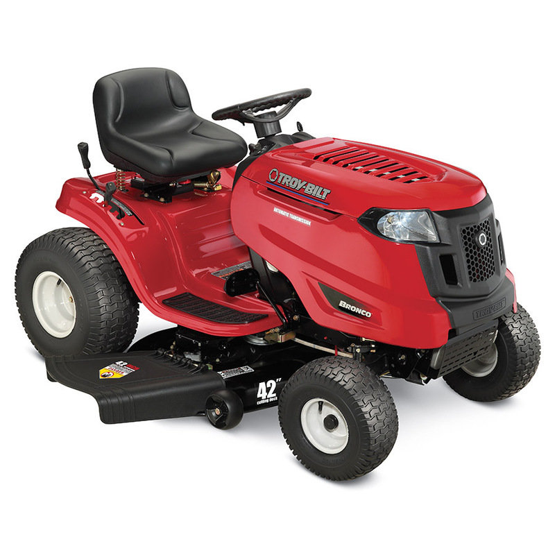

    This is a troybilt lawnmower. It weighs about 490lbs, and has 17hp.
    Let's hitch up! 17hp/10490lbs =.0016. Arguable not as good as the tacoma but let's be reasonable and adjust that load a bit. I mean it is just a lawnmower. But it looks like if we drop the total load to 2500lbs, we end up with a ptwr of about .006. Just as good as a fully loaded, to the gills, semi truck. And at what a bargain! Knock that down to 2klbs and just watch that lawnmower fly down the interstate pulling away from every semi! I mean it HAS TO because the power to weight ratio is better!

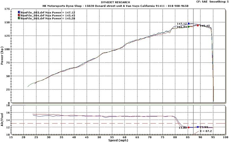

    This is a dyno chart. Is it my truck? No its not. It's probably not yours either and it doesn't actually matter since you can run the same engine back to back and get different results. Hell it could be a honda civic and still not matter as it's just being used to illustrate a point.
    At peak the engine produces 147hp (I should have grabbed one that shows torque as well, but I should also be working right now).
    Where else does it produce 147hp? Exactly nowhere. At that rpm and that rpm only, it is doing everything it possibly can. So at that engine speed you have x power to weight, but the entire time the engine is trying to get to or maintain that rpm, the ratio falls by magnitude. If the engine doesn't produce enough torque to get to that magic number or sustain it, it falls substantially. And you'll notice how peaky that climb is, and how fast it drops off from that peak number.
    Gas engines are never at a steady state unless you have absolutely ideal conditions so the actual hp will vary from pretty much 0 all the way to 147. Move from flat land to a hill (most of my towing experience is mountains, if you live in kansas it might not matter) RPM drops, hp drops and pretty soon you have 2 choices. Downshift or stall. So you downshift and bam! right back to 147hp (for this example why not), except you're down a gear. Can your truck do 80 in 4th? Maybe. Is it happy? Not really. Is it actually spinning faster than it's peak rpm and therefore producing less hp? Probably. And I can't shift up to 5th because my engine doesn't produce enough torque to pull that load in that gearing. And once the climb increases, rpm drops again, hp drops, and now you're in 3rd. You may pass the semi's on the flats (given enough flat)
