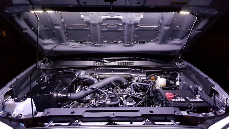

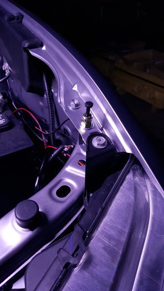

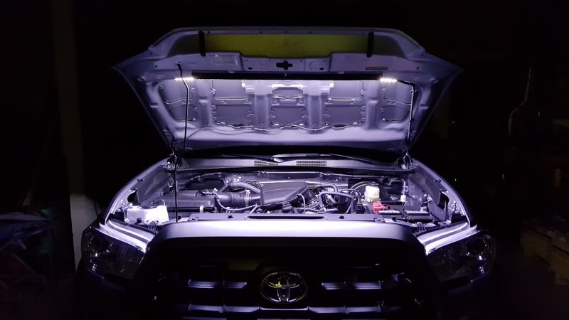

    This is what you need right here, used one like this for my hood lights. I'll post some pictures of my setup!

    Out of curiosity, how did you wire it? Where did you run the wires for your light? Did you come down the hood and past the drivers side hinge for a path? And I'm kinda of confused looking at this switch. Only one wire? I thought it would have a 12v in, 12v out, and a ground? How does it tie in to your system?

    Or am I retarded? I just thought that maybe this is the grounding point? Is that the idea? Switch closes, grounds the circuit, lights come on?

    I came down last the hinge, you can see the wire in the picture.
    Yep you got it!

    Did it the other night. Works great. It's a ground switch. Run your negative line to it. Breaks the circuit with hood closed.when you open the ground makes contact and light comes on
