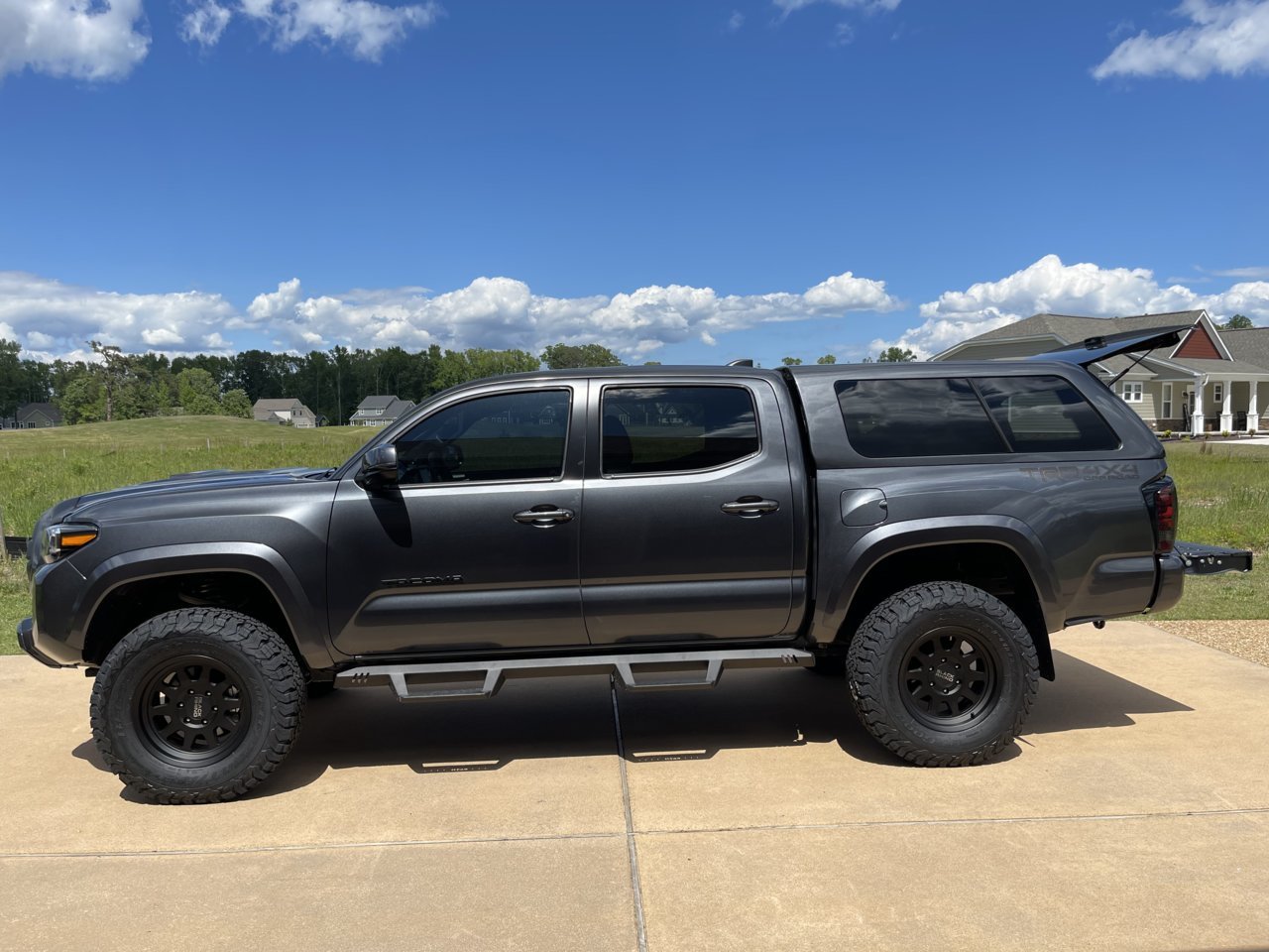

    Real world mounted diameter. If anyone needs it. I did. I know have it. Just sharing.
    BFG AT KO2 C rated 285/70/17 on 23 DC 4wd TRD S on 8.5” wide wheel 0 offset Measure 32” and fit on my rig w no rub. 2” lift up front.
