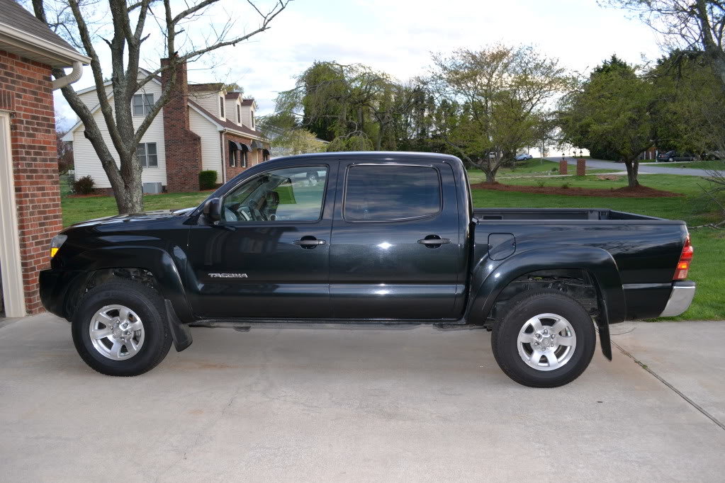

    Of these wheels on my truck and if a 265 70 16 will work on them. I actually kind of hate these wheels, but being realistic, there aren't too many affordable aftermarket wheels I like. Need to know if the above mentioned tire will work on my truck.
    Thank you ahead of time.

    You could run 265/75 and still won't rub on those (assuming they are 16s)

    Yes. 265/70r16 will work. That is the stock size for TRD Off Road models.
    You can also fit 265/75r16 without rubbing. That is a 32" tire (roughly) vs the stock 31"
