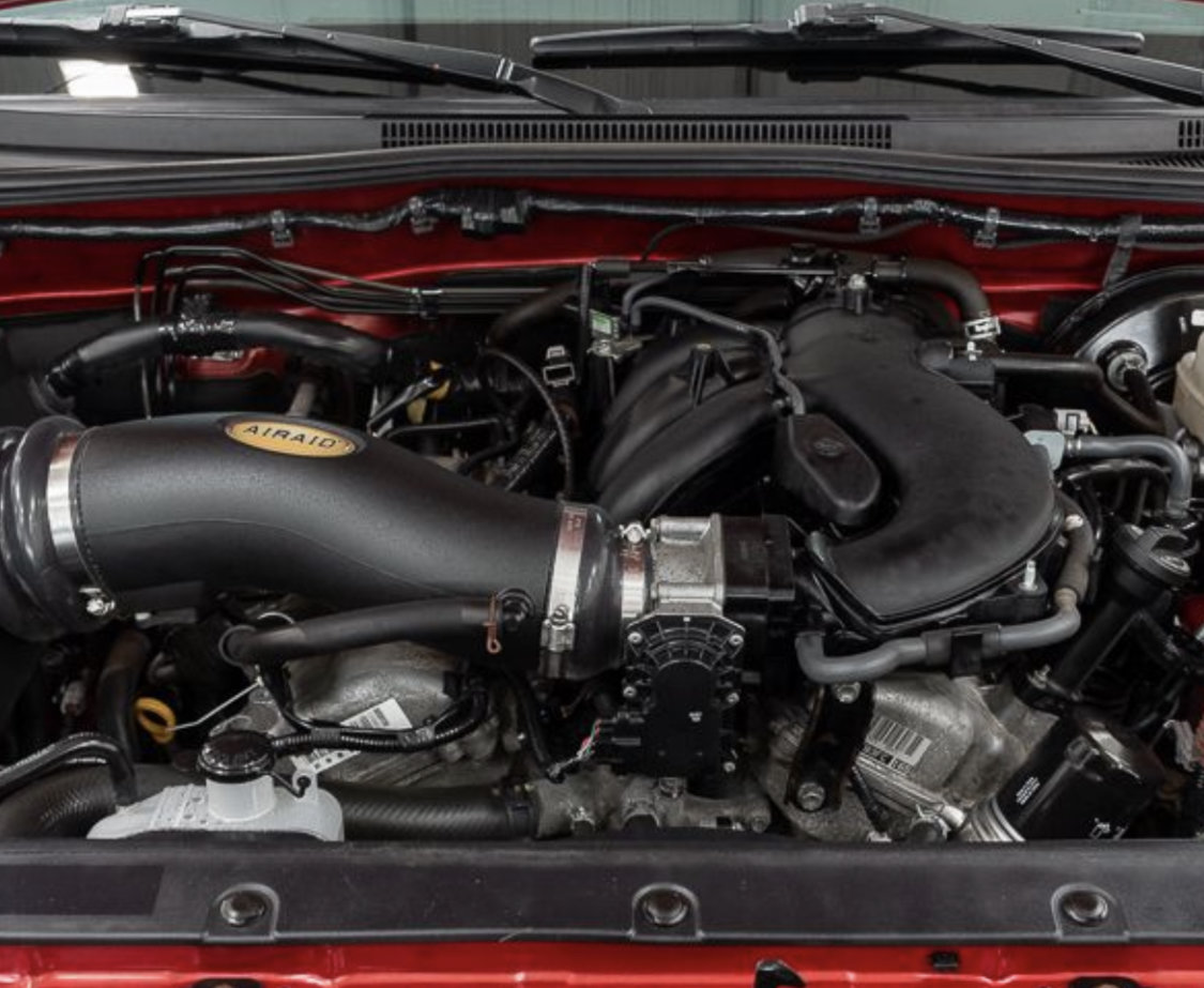

    What engine is this ? 2015 V6 according to the dealer.. but this doesn’t look right . Is this a turbo? A 2.7?13820E3B-1EE2-43C9-A475-EB2E8C267CF7.jpg

    Look like a v6 to me, I see 2 valve cover. Should be a 4.0. Definitely not turbo but a cold air intake. It's missing the plastic engine cover.

    V6 with an intake, no plastic cover and not an off-road if that matters to you.

    typical 4.0L V6 with a cold air intake installed and missing the top costmetic engine cover.

    agree with the above, you can see two banks of cylinders. Definitely a V6.

    The same shit everyone else has.
    1GR-FE minus the oem engine cover plus an aftermarket intake.

    How can you tell it’s not an off-road?

    Off-road's had the electronic brake booster and the truck in the picture has a vacuum one.
