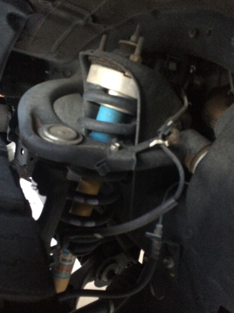

    I bought a used TRD Sport about a month ago and the previous owner claimed it had a 3" spacer lift. After putting on some 285/65/18's, there's some pretty significant rubbing.
    I am planning on a coilover lift soon, but in the meantime would like to know what i'm working with.
    Can anyone tell me what this is?
    7B371369-91BE-44F7-B2C2-0681DEE67A4F_zps_f4cef6fef48410f5050b8e40b1ee1bb5c6715a1c.jpg

    It's an in coil spacer lift. Looks like stock shocks and coils.

    ^ What he said. I think Toytec and some other companies etches theirs. Otherwise it's a basic spacer. Stock coils and shocks. Coils could be sagging as well.
