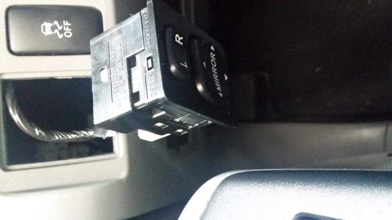

    Does anybody know what wire has power? And how many volts it might be?
    Thanks

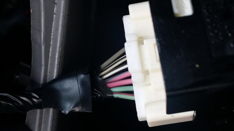

    ^^^^ This Gray is power, white/black is ground.
    The pink wires go to the left side mirror.
    The green wires go to the right side mirror.
  3. Apr 23, 2015 at 2:09 PM
