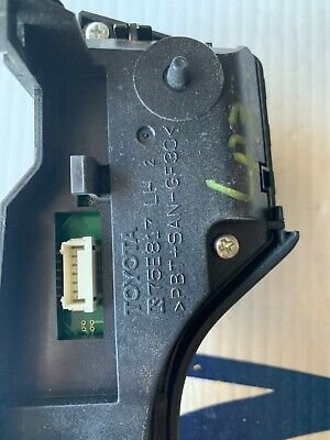

    From this picture. I bet i can cut the trace on the pc board and run a wire to each pin of the connector and change it..
    If i find one cheap ill do it.
    And document all of it.

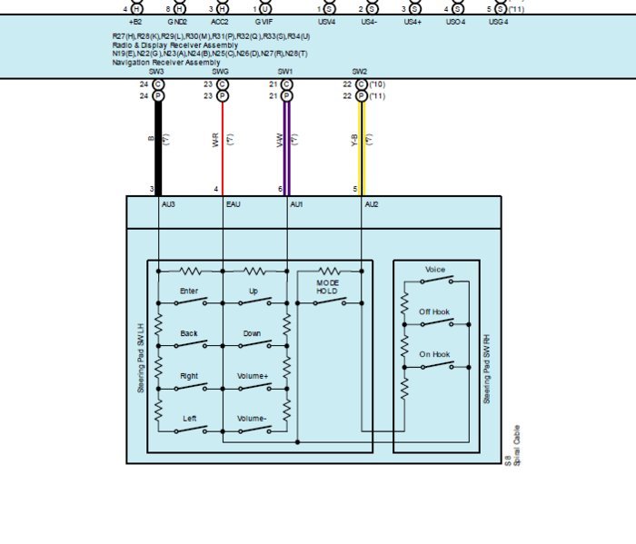

    Or its even easier. Each button may engage a different set of resistors to set different voltages on the outputs. Radio reads those voltages to determine what button is pressed. Rearrange the resistors and you can rearrange what button does what.
    from:
    https://www.tacomaworld.com/threads/repurposing-steering-wheel-buttons.410411/#post-11594841

    When I installed a new head unit it required a Maestro RR2 to integrate with the Tacoma wiring. I was pleasantly surprised to learn that you can reprogram the buttons on the steering wheel to any functional configuration you want. My volume is now up and down and tuning is left and right. So maybe look into the Maestro unit to see if you can add it to your stock head unit?
