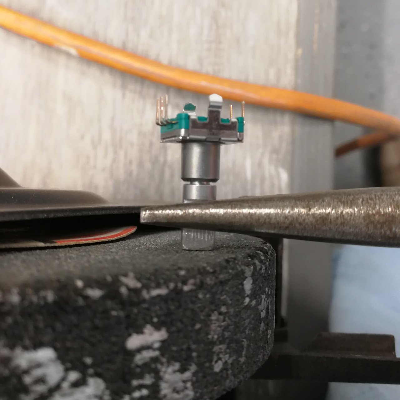

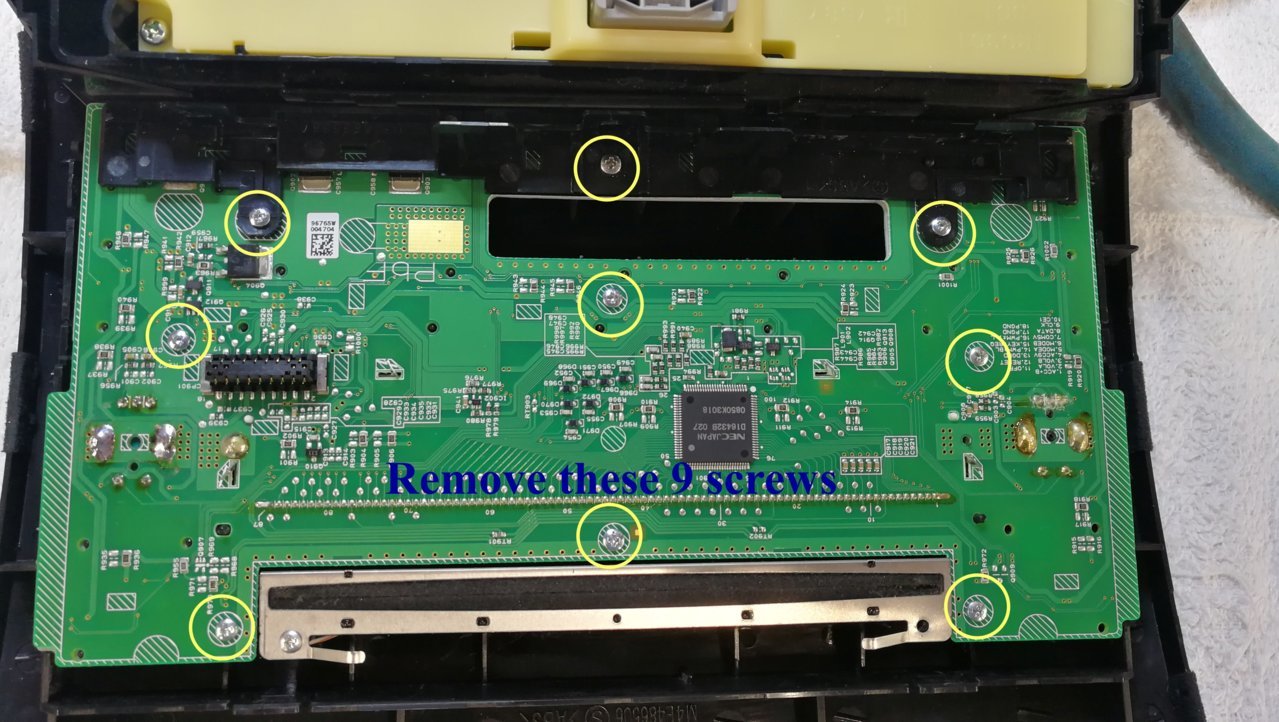

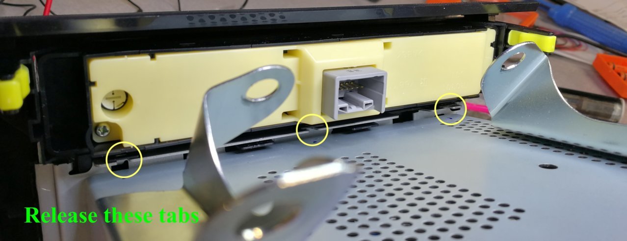

    I have a fix. My unit is fixed and working great!

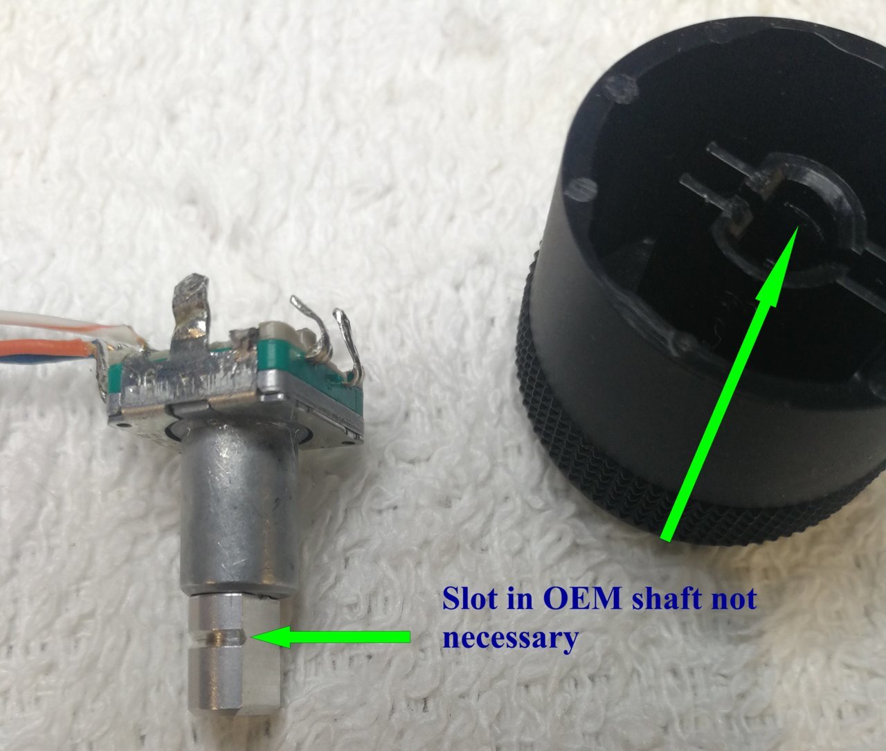

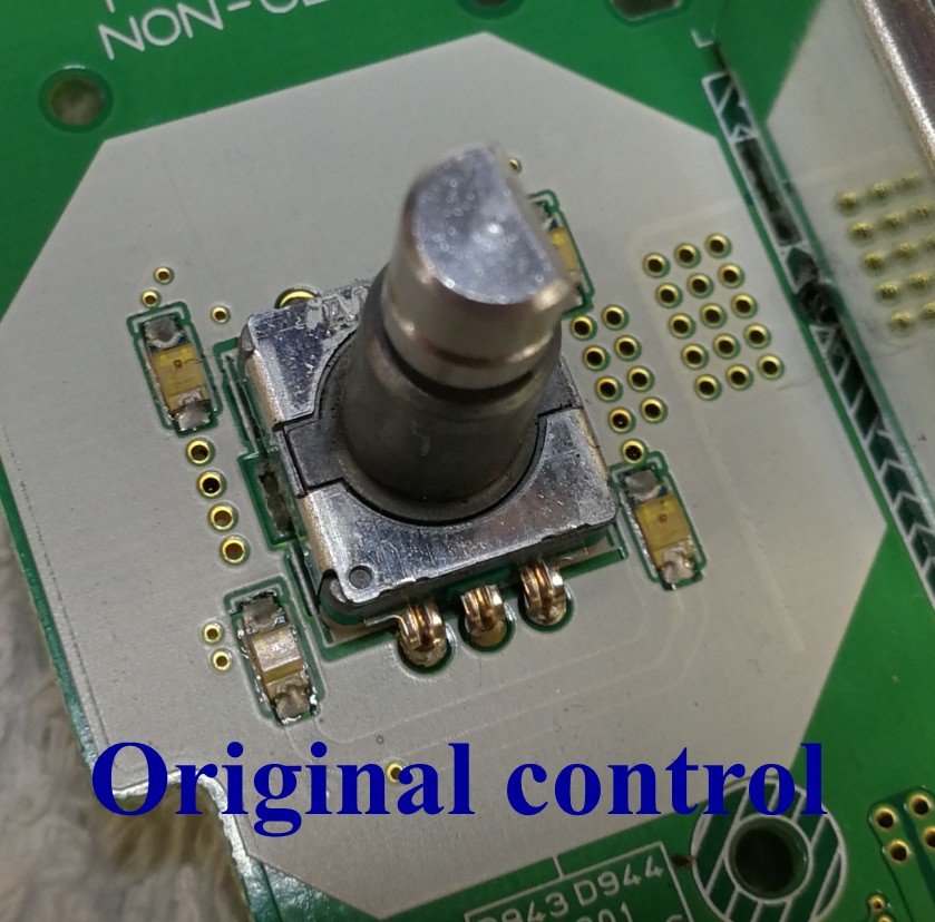

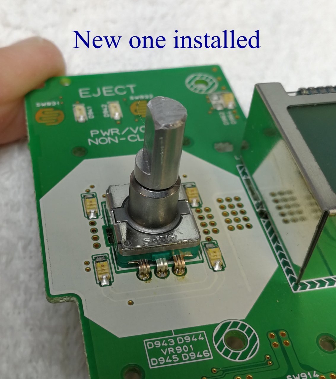

    I've seen so many people just say they replaced the OEM unit with a new stereo when the stock stereo works fine other than the volume control. This is a $5.00 part and if you're a little electronics savvy it can easily be replaced. You'll just need a good soldering iron and a solder sucker or solder wick and some basic tools.
    I was not able to locate the exact ALPS control in the unit. I'm guessing ALPS made it special for Delphi (who made the stereos for Toyota)...not sure. But either one of the ones below will work.

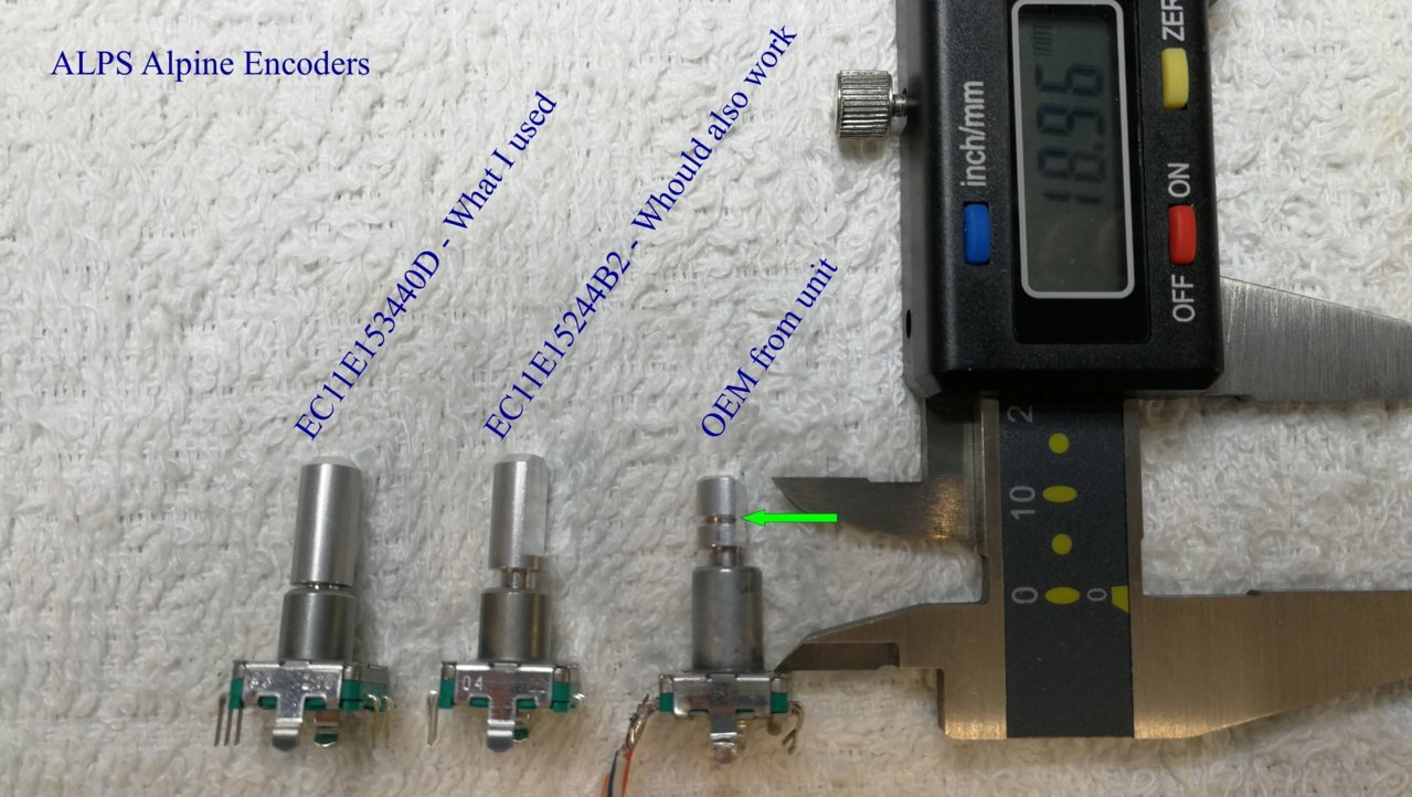

    Here are the two ALPS models I ordered from Mouser Electronics
    EC11E15244B2 11mm 15 RES 30 DTENT
    EC11E153440D 5 Volts Through Hole / This is the one I used but either one would work

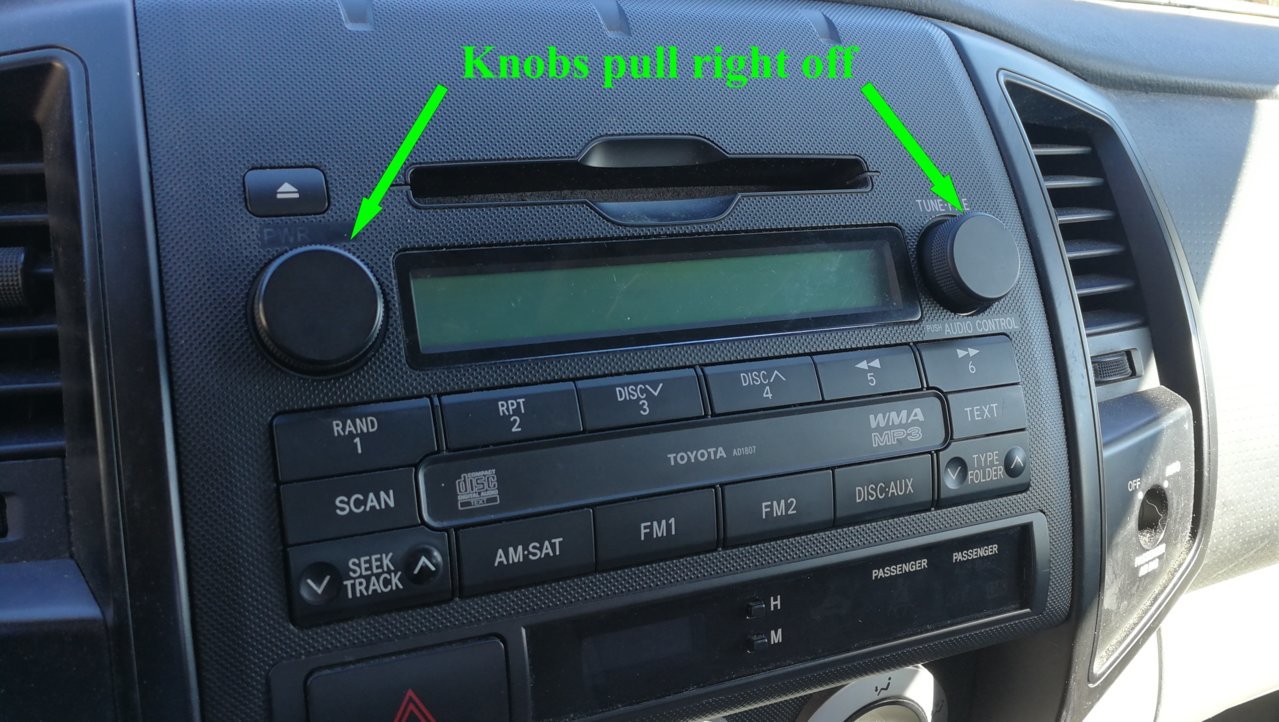

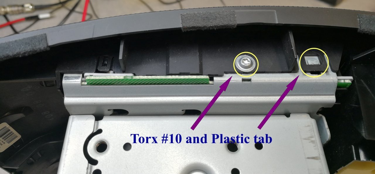

    There are plenty of YouTube videos of how to remove the unit from the dash so I didn’t go into that…it's very simple (4 bolts).
    These ALPS encoders can be ordered from many different suppliers such as Mouser Electronics, Newark, Allied Electronics, etc…just Google the part numbers.
    I also took the old encoder apart and confirmed it was 15PPR (pulses per rotation) so I did order the correct types mentioned above.
    The two different types I ordered are physically the same size. The difference is one of them has 30 detent's when you turn it and it has the original 1.5MM travel for the push button (power). I used the other one I bought with no detents (smooth when you turn it like the original) and it has a shorter .5mm travel for push button (power) which worked fine.
    The only minor issue is the shaft length on these is slightly longer than the original (~1.5mm or so) you could still install it as is and the volume knob would just be slightly taller and no big deal but I ground mine down to the same length as original using a bench grinder. The shaft is aluminum and is easy to grind down. Just make sure you hold the shaft with pliers as not to stress the encoder and cause damage. The other issue (which is really not an issue) is these do not have the groove in the shaft that helps hold the knob. I found the knobs are plenty tight without the groove and absolutely do not pull off unless done intentionally.
    I hope this helps some of you. Questions, comments, ideas are welcome.
