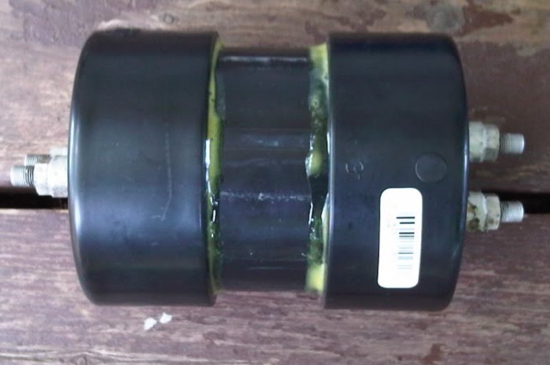

    If you want to pull the TPMS from the wheels, you can build a cheater cylinder* for the sensors and just keep it in the back of the truck inflated to 35 psig.
    Probably better that cutting wires.
    *Please note, not my creation; image pulled from the 'net.
