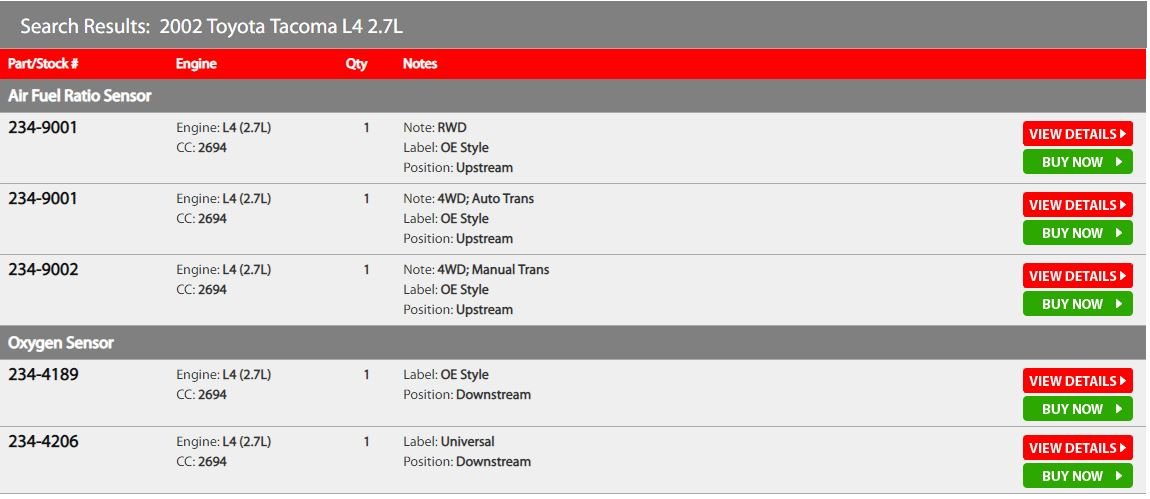

    I don't understand. You currently don't have a code? If not, don't mess with it. Do your LTFT look good? Leave it alone. Also, you sensor part numbers don't match anything I know about sensors. Check your part on Denso website. Your 02 is a wideband upstream and a narrowband downstream. As long as you have the right type, the different part numbers are just different lengths of wire. Check out this snip I pulled after I put in your truck info.

    89467-35011 is an alternate part number for the sensor which is the Denso 234-9002 which is currently on my truck. 89467-35050 is 234-9001 which should be the one for my specific trim.
