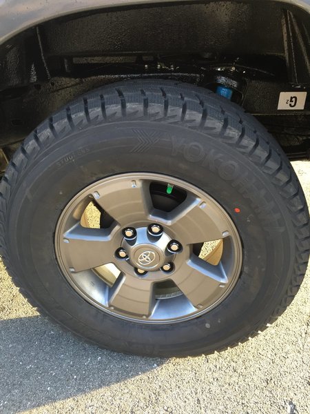

    I actually bought a set of those wheels to use for winter that looked just like that. With enough sanding and some duplicator wheel paint, you can make them look pretty good.

    Thanks. It was actually a lot more work than I expected, but I'm happy with them though.

    I assume it's from salt and not being washed often enough. The ones I bought were from a 2009 and looked just like the op's. It has something to do with the finish too. The face of the wheels weren't bad, but the painted area between the spokes had the paint flaking off and was really pitted.

    It's duplicolor wheel paint. The colour is "graphite." Very easy to apply too...the prep work was a pain in the ass though.

    What all did you do to prep the wheels?

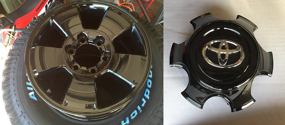

    Your wheels will likely be fine after a media blast and powder coat but I agree with Vandal on finding another set. I found an extra set of Sport rims (from an '09) on Craigslist for $100! They were in much better shape that my '06 set.
    I paid $275.00 for a local powder coat shop to blast and powder coat them in gloss black. Turn-around time was 5 days.
    I removed the chrome Toyota emblem from the '09 center caps, painted the plastic with Rustoleum Gloss Black Engine Block rattle can paint. Then snapped the chrome emblems back in.
    After looking at countless after market rim options and styles, I'm really happy I with the powder coated factory wheel. Love the look of this wheel in gloss black. For $375.00 total investment I can't complain either.
