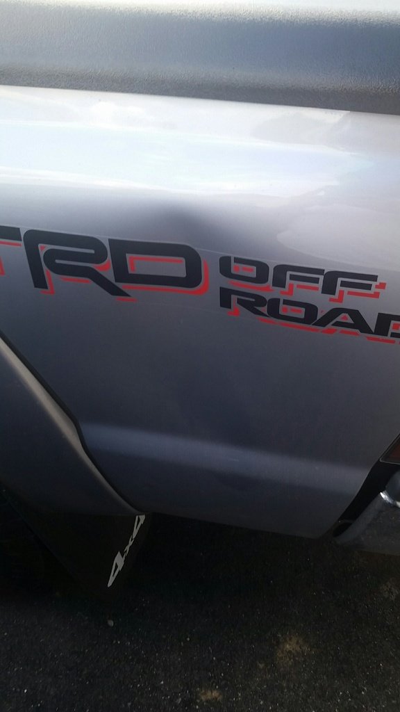

    I was performing some maintenance on my 2006 Tundra, which was parked right next to my 2015 Tacoma.
    I accidentally stumbled, and fell against the driver's side rear fender of the Tacoma.
    Could a dent like this be fixed with one of those Paintless Dent Removal services, or is this dent too big?
    If Paintless Dent Removal would work, anyone have any recommendations for such a service in the Fairfax, VA area?
    Picture:

    Should be able to fix that. I don't see a crease in the metal.
    You might pull the bed lock box and gain access to that area and try to push it out yourself.

    I'm guessing yes based on some dents I've had removed. Is there a crease up at the top?

    Reach up in the fender and pop it out with your fist. Should come right out.

    yes, you can do it yourself or have the paintless stuff done. That shits gonna buff out.

    IMO, yes, that will come out.

    yes. No crease. Any decent dent person can fix that 100%

    I went under my truck, and punched it most of the way out.... I had a dent like that .. Now it's not real noticeable... Punching it out is free....

    even with a simple dent like op, i wouldnt be surprised if he tried to pop it himself, that there could be some residual waves/ripples. For such a new truck i would have it professionally fixed, and forget it ever happened. Ask me how i know. I love p.d.r:D

    bucket of water and a (clean) toilet plunger. splash, gently attach the plunger, and give it a tug. paintless dent removal.
