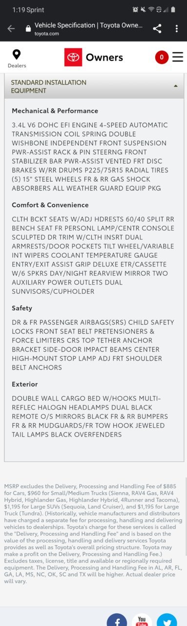

    Mine VIN print out shows info under the following headings, AC being under Interior.
    Their method of display may have changed over the years, but it might not hurt to look again.
    MECHANICAL & PERFORMANCE
    SAFETY & CONVENIENCE
    EXTERIOR
    INTERIOR
    Air Conditioning

    Is that from the Toyota website?

  17. Jan 31, 2021 at 10:22 AM

    It is. I just copied out the headings, lots of things listed under each one. I think it was called Vehicle Detail. Same place I got the owners manual and all the subsystem operating manuals
    Yours says AC under Factory Installed, right between the radio and clock listing.
