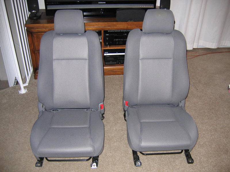

    I have a set of TRD Offroad seats, complete with brackets and all the sensors, out of my 2006 Access Cab. Pretty much mint condition.
    I'm in NJ and open to offers. :)
