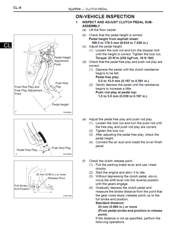

    I've had my 2013 manual transimission Tacoma for about two weeks now and I find the clutch highly annoying. Compared to my 2001 Tacoma and any other car I've owned, the clutch on my 2013 "lets out late"... i.e., it's not until the clutch is almost fully depressed that the car will actually go. I've been driving with a manual transmission my whole like (over 20 years) and I'm finding the clutch in my new truck is really hard to get used to.
    Is there a reason for the clutch letting out so late? Can it be adjusted to "let out early"?

    From the FSM:
    ON-VEHICLE INSPECTION
    1. INSPECT AND ADJUST CLUTCH PEDAL SUB-
    ASSEMBLY
    (a) Lift the floor carpet.
    (b) Check that the pedal height is correct.
    Pedal height from asphalt sheet: 168.5 to 178.5 mm (6.634 to 7.028 in.)
    (c) Adjust the pedal height.
    (1) Loosen the lock nut and turn the stopper bolt until the height is correct. Tighten the lock nut.Torque: 25 N*m (250 kgf*cm, 18 ft.*lbf)
    (d) Check that the pedal free play and push rod play are
    correct.
    (1) Depress the pedal until the clutch resistance begins to be felt.
    Pedal free play:
    5.0 to 15.0 mm (0.197 to 0.591 in.)
    (2) Gently depress the pedal until the resistance begins to increase a little.
    Push rod play at pedal top:
    1.0 to 5.0 mm (0.039 to 0.197 in.)
    (e) Adjust the pedal free play and push rod play.
    (1) Loosen the lock nut and turn the push rod until the free play and push rod play are correct.
    (2) Tighten the lock nut.
    (3) After adjusting the pedal free play, check the pedal height.
    (4) Connect the air duct and install the lower finish panel.
    (f) Check the clutch release point.
    (1) Pull the parking brake lever and use wheel chocks.
    (2) Start the engine and allow it to idle.
    (3) Without depressing the clutch pedal, slowly move the shift lever into the reverse position until the gears engage.
    (4) Gradually depress the clutch pedal and measure the stroke distance from the point that the gear noise stops (release point) up to the full stroke end position.
    Standard distance:
    25 mm (0.984 in.) or more
    (From pedal stroke end position to release
    point)
    If the distance is not as specified, perform the
    following operations.
    Pedal Height, Push Rod Play, Pedal Height Adjustment Point
    Push Rod Play and Free Play Adjustment Point, Push Rod Play, Pedal Free Play 25 mm (0.98 in.) or more Release Point, Full Stroke End Position
    • Check the pedal height.
    • Check the push rod play and pedal free play.
    • Bleed the clutch line.
    • Check the clutch cover assembly and disc
    assembly.

    Yes you can! Actually Jimmyh posted it but hear it is in layman's terms. I just adjusted the clutch pedal free play or the clutch pedal engagement point, it was driving me crazy. I've owned my 06 six speed for a few months bought it used with 173,000 I just figured it needed a clutch. But I did a couple clutch tests and towed my boat several times the clutch never slipped and I never smelt clutch. I bled my clutch slave, searched this forum and never really got a good answer but found that plenty of people with the same problem. So here's how you do it, you need a 12mm and a 14mm combination wrenches look under the clutch pedal arm (inside the cab) you'll see a rod with the 12mm jam nut and a 14mm square end above the jam nut loosen the jam nut twist the rod by hand til you have a couple inches of free play, free play is the down ward travel on the pedal until you feel resistance. Start your truck in neutral make sure it goes in gear and lets out where you like it shut your engine off and tighten the jam nut and your done should take all of five minutes.

    Followed the instructions by stixnstrings (and jimmyh) and worked fabulously. And like abbazaba14, I saw that there was free-play in the pedal travel before engaging the plunger, so i took a thick washer and nut (m8 x 1.25 ?), and placed them on the exposed threads of the "pedal height adjustment point" where the clutch pedal arm contacts. Now the pedal rests about 2" down from where it was originally, which is much more comfortable as there isn't any free play and though the engagement is still a little high for my taste, it's leagues better than it was. I now feel comfortable letting others drive it without worrying to tell them that its a pain in the ass to clutch-in/out.

    Hate to bump an old thread, but I've got a question on clutch pedal adjustment. I was going to do this about a month ago, but ran into an issue. I was going to adjust the bumper on the end of the pushrod, but the bumper wouldn't turn after the lock nut was loosened. It would turn but there's a square nub that interfaces with a square hole on the back of the clutch pedal.
    Are you supposed to push in the pedal to turn the bumper? Or do you turn the pushrod and the adjustment occurs because the bumper is stationary?
  19. Dec 21, 2016 at 1:27 PM
    #19
    shakerhood
    shakerhood Well-Known Member
    Aug 9, 2015
    #161370
    36,983
    Southern Ohio
    2017 MGM DCSB Off Road, 6 Speed MT, P&T
    If memory serves me once you loosen the jamnut the you turn the rod in and out, just make a paint line on the rod so you can see how far you turned it.
