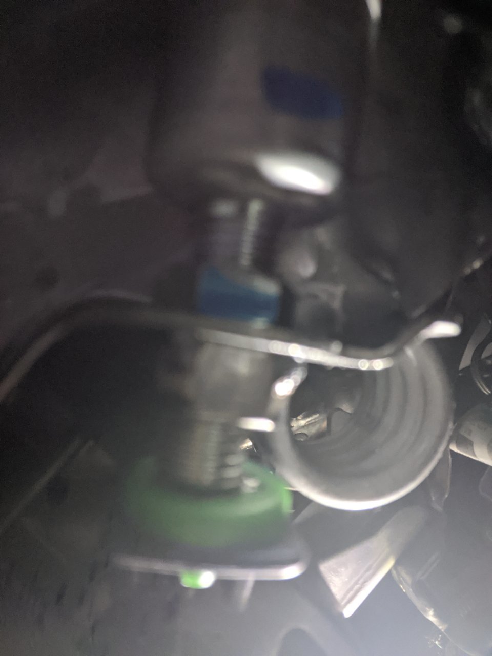

    I would also like to adjust the clutch pedal height but I can't get a wrench on the locknut.
    Does anyone know what size wrench bI need for the locknut? I tried everything from 11-14 mm without success
    I took this bad picture with my phone, it's the top blue nut I need to unlock to screw it down. What is metal cylinder on top? It looks different than the Toyota diagram on page 1 of this thread

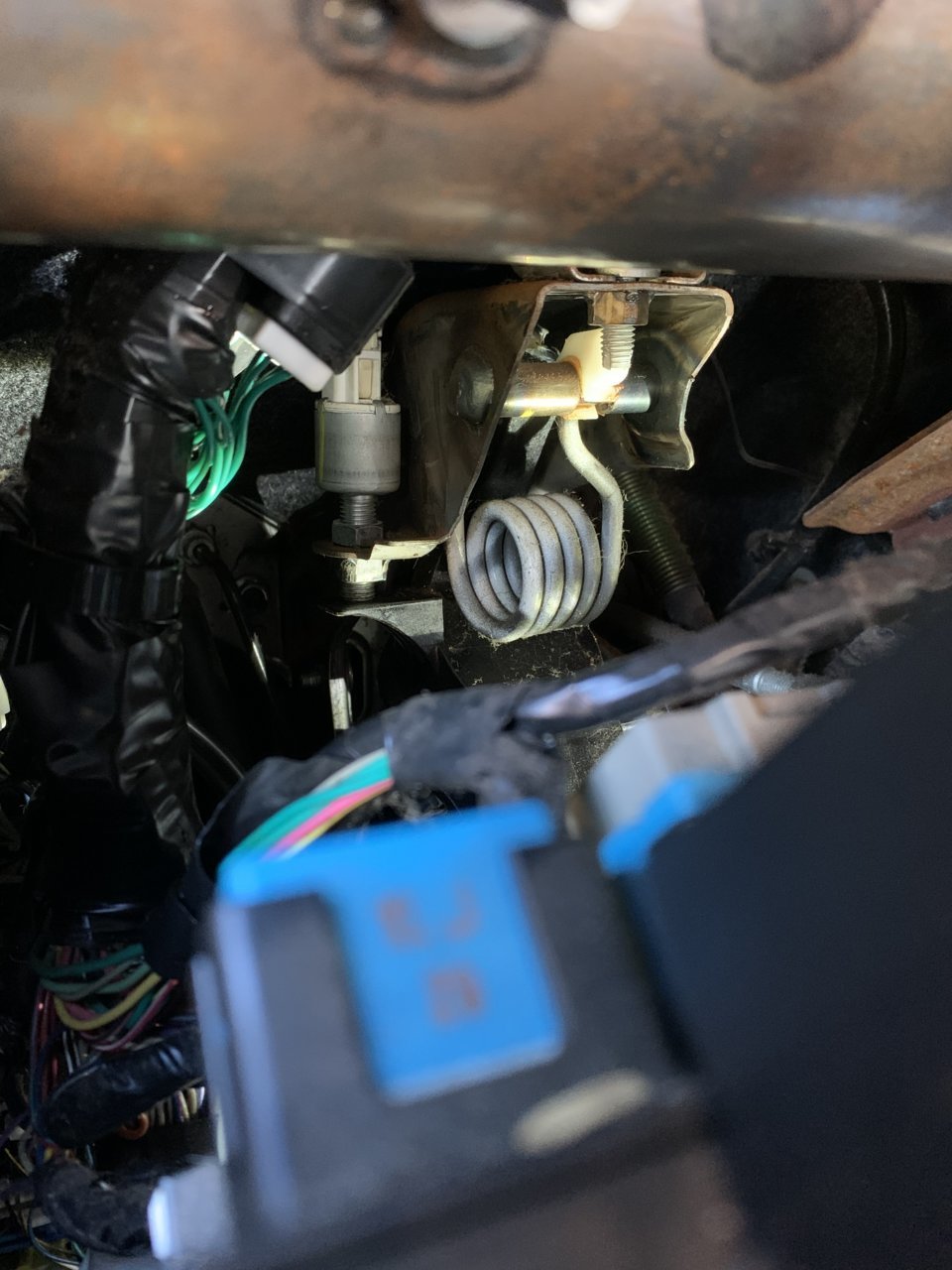

    Anyone know what this sensor does? Appears to be part of the clutch pedal height adjustment and has a spring loaded button that goes through a hole (never gets tripped)

    I think that is the clutch switch that kicks it out of cruise control when the clutch is pressed. There should be a rubber cushion pad that mounts through the hole and will prevent the pusher on the switch from going through the hole.
    Does your cruise control work. I think it doesn't.

    I think it does work, but will check it out and update. Maybe it works but the system doesn’t register it

    To close this out, yeah that missing plug required to push that button on the clutch IS for cruise control purposes.
    mine is missing (per pic in prior posts) and my cruise control no longer works. Fucking gremlins.. original owner, never pulled it out myself and it disappeared - go figure..
    a little gorilla tape or an hour of cad/3dprinting should do the trick.
