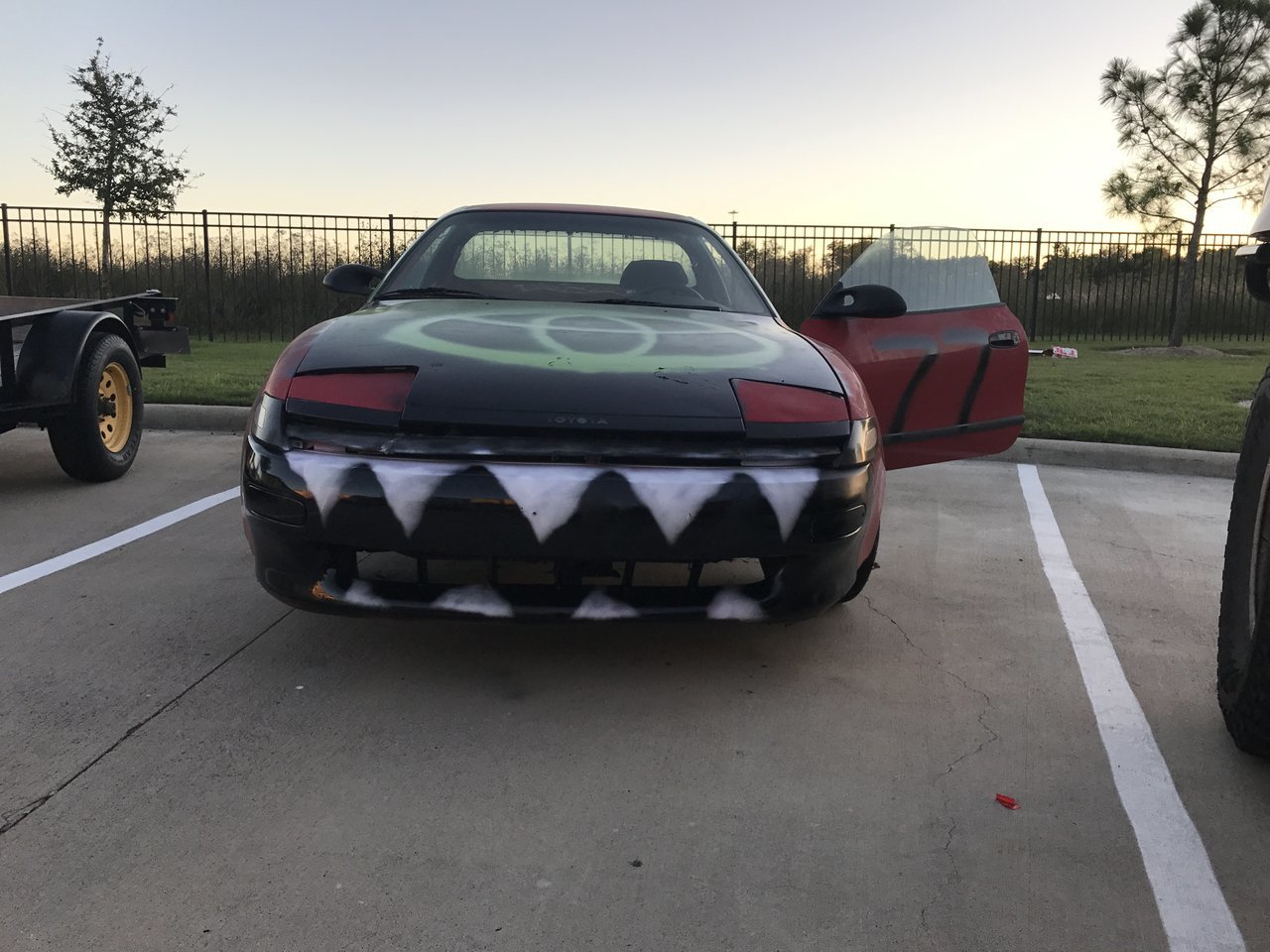

    I'm in. I just got the sparco seat for the celica and Takata 5 point harness in the mail. Here is what I'm working with so far...

    hell I'd drive! Was in a similar boat a few years ago, not enough interest among friends. Was gonna do a 81 El camino up. Still have it.

    Possibly a backup car. I figured early 90s Japanese steel would hold up in an endurance race, plus I got the car for free in exchange for helping a buddy with a motor swap.

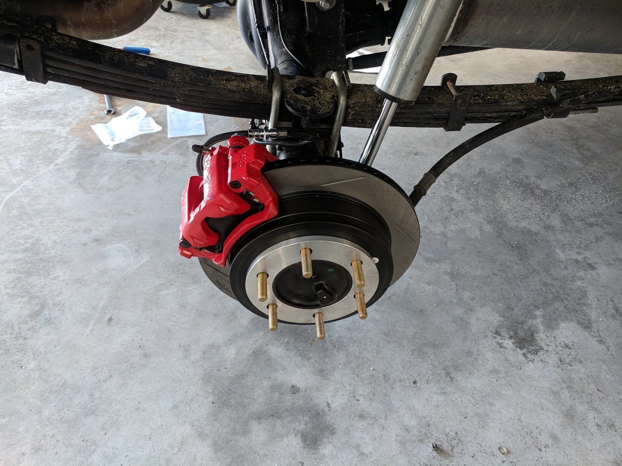

    I bought the mounting plates from SOS and put 4runner disc brakes on. With ABS disabled the rears locked up first, but I already bought the lines and proportioning valves for the actuator delete so it didn't really matter. Ended up not buying the adapter for the 4runner MC.
    The main reason i got rid of the drums is because I think they look like shit and I was opening the system for the actuator delete anyways. The only thing I'd have done differently was not coming to the forums and reading through pages of people telling me why I shouldn't do it.
    Couldn't be happier with the new setup. It's exactly what I wanted and only costs a couple hundred bucks.
    EDIT: To answer the OP's question, the braking is not noticeably better as far as stopping distance is concerned. The install was extremely easy. Hardest part is cutting off the drum mounts, which only takes a couple minutes with a grinder. The best thing I've done for my braking is bypassing the ABS actuator and running new lines. The pedal feels amazing now. Before it always felt spongy even after trying the ABS bleeds discussed here on the forums. Used a vacuum bleeder and speed bleeders and it always felt like crap before.
