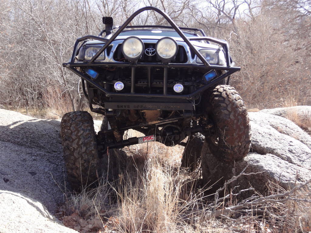

    here we go. Ford 9" rear after breaking 5 sets of gears in the stock yota 8.8, 5.13 gears with a detroit hard locker, 63" chevy leafs and custom hangers, sky's front spring hanger with sky's extream hysteer and PSC hydro assist ram and PSC pump. welded front spyders in the f-550 front dana 60 with warn hubs, pico brake lines and hoses, elecrtic fan, TRD supercharger with URD 2.1 Pully, URD Map-ECU2 and cage built by me. wide band a/f by inovations, lots and lots more...........
    DO NOT STACK SPACERS!!! and if your offroading ur truck DO NOT USE BLOCKS IN THE REAR . #1 stacking spacers on the front struts will BREAK UR CV shafts like they were mad out of wood trust me autozone hated me for life time cv shafts lol and truck wont articulate at all... lots of stress on the strut buckets... #2 blocks in rear is STUPID!!! wheel hop can and will happin due to pivot point of spring and axle seperated can also shatter pinion gears.... and finaly the driveshaft angle will be out of wack unless shimmed but shims with blocks very bad combo!!! check out the blocks and steering on some of these trucks lol http://128.83.80.193/scarysteering/index.html

    ditch the drop bracket and body lift idea... SOLID AXLE that truck...
    if you really want to go that high, do it right and make it a chick magnet at the same time...
    you will be able to actually wheel the piss out of the truck offroad and at the mall...
    Pep's truck...

    or even better, Yotabeast505...

    That truck is in the running to be in TTC. Yotabeast505, you should apply to be in it!!1
    in the TTC huh? have no clue what that is but looks like the TOP TRUCK CHALANGE OR THE TOYOTA TRUCK CHALANGE LOL witch is it and were do i apply lol
