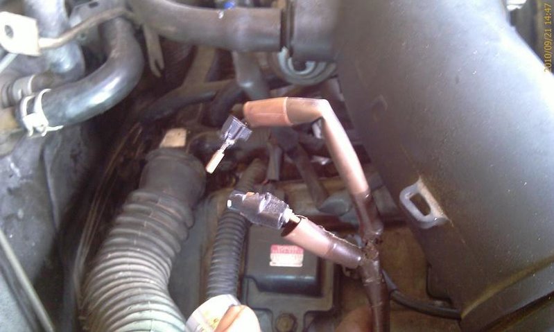

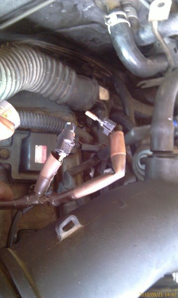

    I was given this truck. There was no engine. I had to purchase a new rebuilt engine. My ex boyfriend and I installed the engine. He is now not in the states.
    Truck is running ok. Not much power. Probably due to the below pics? I have combed through the manuals and can't locate.
    You can identify these and tell me where do they go?
    Thanks a million.

    looks mike PCV and mabye MAF????

    Had to fix the one for a better look. It appears to be a 5vz

    The two wires could be for the Oil Pressure switch and Water temperature sender.

    The Water/Coolant temp sender looks like this
    The oil pressure switch looks like this

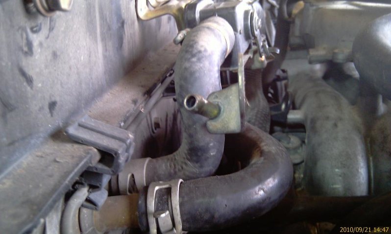

    That tube looks like a tranny fluid line to the radiator...

    1998 SR5 V6 engine.
