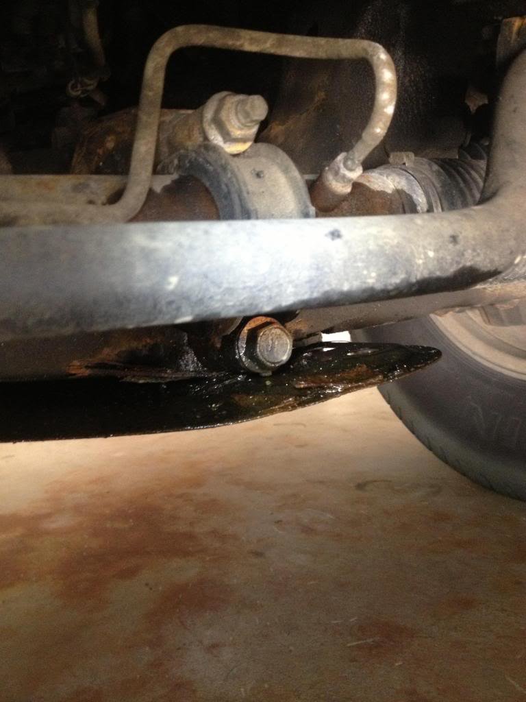

    Hi Gang,
    Just bought an 04 Taco Quad Cab TRD. Got it from a used car dealer. They are a good bunch of guys. Truck is in good shape, and I am happy so far.
    Crawled under the truck to have a look around, and spoted this:
    What is the cause of this leak?
    What needs to be done?
    Is it serious?
    Thanks for any advice!

    Looks to be the power steering rack area?

    Could be the rack or maybe a leak from back of engine (valve covers)
    Hopefully not a main seal, I've got a simliar dribble & traced it back to rear valve cover on pass side, as with all leaks they need to be tended to, maybe not an emergency but don't let it go too long...:)

    First, determine what type fluid? Looks to be power steering fluid and it looks to be coming from the rack and pinion. $300 and replace. Either way in that botoom pic the the rack bushing doesnt look good so id be replacing that also. You can get a set of polyurethane ones from energy suspension or wheelers.

    Looks like power steering fluid from the rack unit.
    Keep an eye on the PS fluid level, if it's not leaving drips where you park, I wouldn't worry about it.

    It looks like it could be your ps rack leaking. I'd pull the belly pan off and see if you can locate the source of the leak. It looks like the pan could just be catching the leak and draining it under your power steering rack.
    Like others have said, see if you can determine the type of fluid. Our trucks use atf for the ps steering, btw. Other than that, get that belly pan off and see if you can figure out if the leak is just coming from the ps rack or elsewhere.

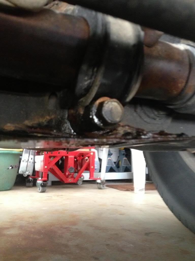

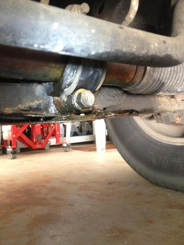

    definitely on both, you can see from the pic very slight fluid spreadage on top part of rack, but basically gushing at bottom side....bushings are toast for sure, you can see the splay is real bad in pic....fluid levels in PS pump have to be getting critical....
    rack replacement, new bushings, as long as you are at it, inner and outer tie rods, I am sure they probably need replacing too, may as well, you are going to have to disturb them for the repair...

    The garage told me that it is a leak in the rack. They are going to fix it.
    A previous poster said that the bushings and tie rods looked shot as well.
    Can they fix this leak without replacing the bushings and tie rods? I wonder if I should offer to pay for the tie rods if they are going to be able to do this job and not replace them. Thoughts?

    You will have to order the bushings from wheelers or ES. Toyota only sales the big bushing under the clamp. I wouldnt reinstall it without new bushings. Tie rods can be done later at anytime. I would guess the are gonna pull the rack to fix it, may as well do inner and outer tie rods and bushings while it is out if they are indeed worn.

    Bushings are shot, if you don't replace them when the rack is repaired/replaced, then you will have mucho play in the steering, it will not track right....the tie rods can be done at a later date, however, once the rack is repaired, the very least would be a toe adjustment and center steering wheel sequence...
    Tacos eat up tie rods for lunch, even more so if you wheel....may as well, that way when it is all done you can worry/upgrade other things...:thumbsup:
