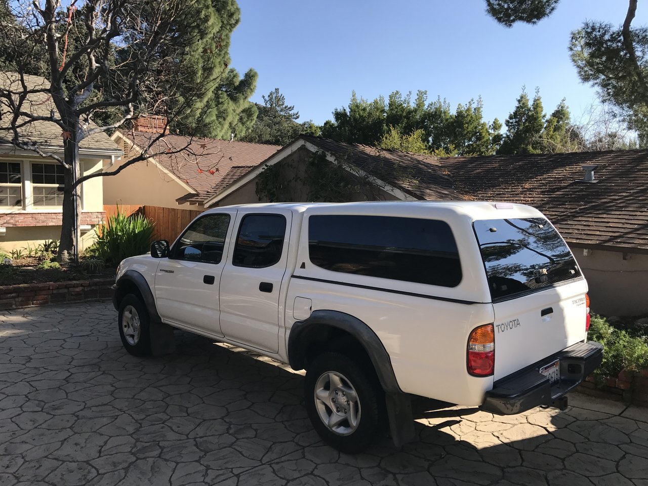

    When leafs are replaced, do shocks need to be replaced, or are shocks/leafs independent of each other?
    Appreciate the help.
    Its a work horse. Cold A/C. All OEM stock. Doesn't burn or leak. It truly is one of Toyotas best. It is the slowest Tacoma on the forum, but gets the job done, day in and day out without complaining :)

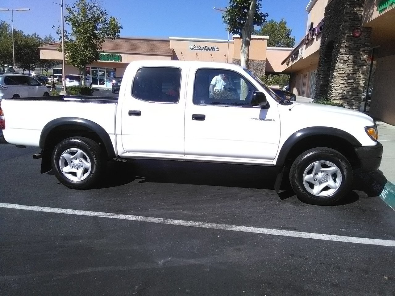

    Also given the condition of the rear leaf, I am surprised it isn't "sagging"
    With and without camper.

    They're independent, but if one is worn, the other probably is, too.
    A good trick is to stand on your rear bumper and jump up and down on it. Does it immediately bounce back and stay still, or does it kind of bounce up and down a few times? If it stays bouncing, you need shocks.

    Just tried it
    It is immediately bouncing back and staying still

    They *should* smile, however these OEM springs were at best 'apathetic' when they rolled off the factory floor. A lot of folks were complaining of negative arch after a short period. Whether you need to replace them, is up to you.

    Ah that makes sense
    With load since it feels bottoming out over bump maybe time for replacement
