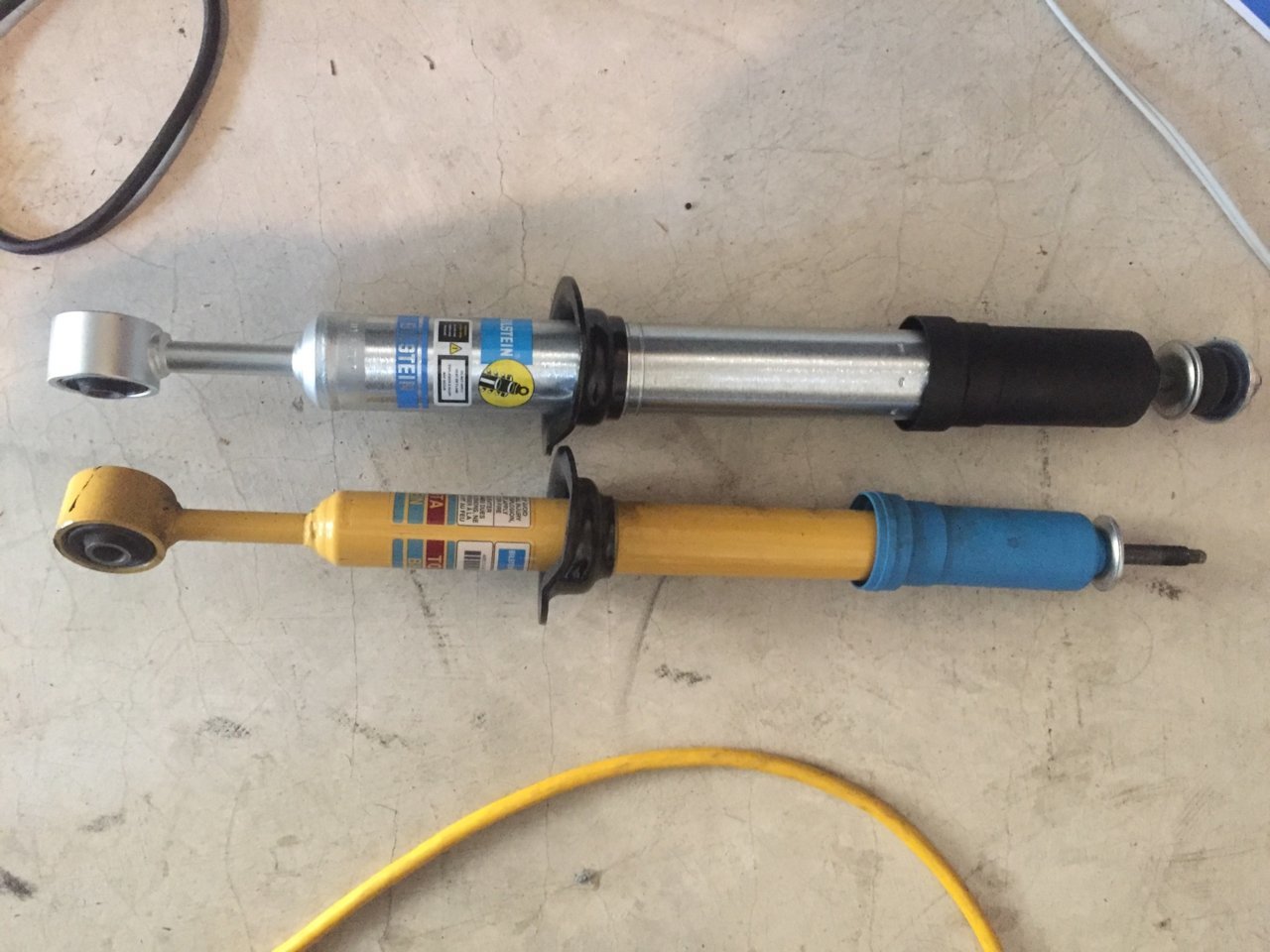

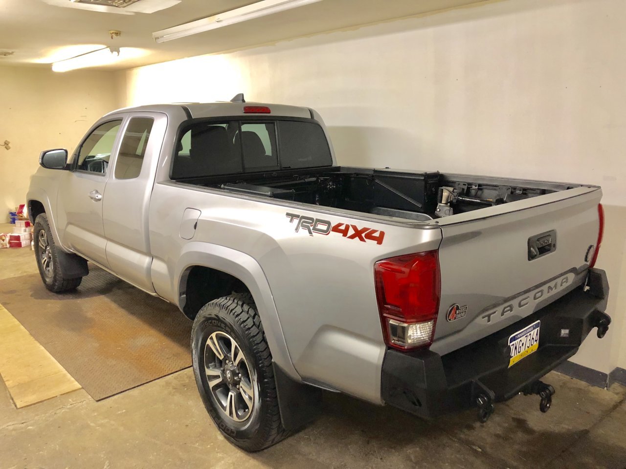

    These are at .65 inch or 2nd ring.
    With the 5100’s positioned at any of the settings, the stock coil height remains unchanged. The 5100’s provide lift by lengthening the bottom tube of the shock as you move the ring up at each position.
    You could keep the stock springs with the 5100’s and get the desired lift if you just want the aesthetic.
    Or, buy better shocks and taller springs. So many choices.
    I can’t comment regarding different springs.
    The 5100’s improve your handling in curves with less lean and body roll, but the ride will feel firm as you lose the soft on road ride of the stock 4600 Bilsteins.1E05074D-1D77-4585-A101-77961E56B71B.jpg EB72F338-85C1-4BD3-970C-1047F8E763D7.jpg

    I’ve got (4) Bilstein 5100s at 1” lift on front and settled to 1/2” with winch and slim bumper and AAL (left overload in) on back for 1.5” settled a little with rear bumper.
    It’s about the same rake as stock just a really slight lift all around. Rides a bit stiff which I’m fine with since I’m on pavement roads mostly.

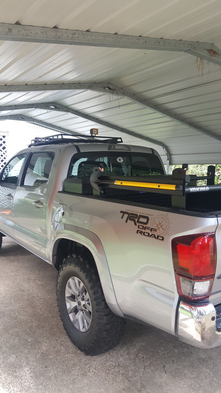

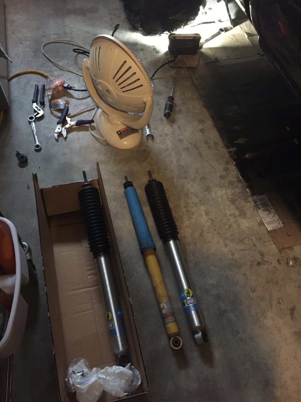

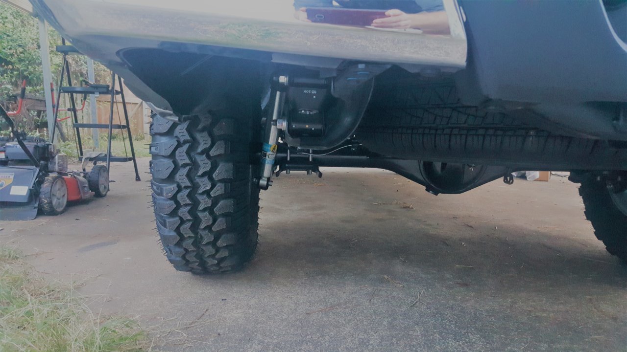

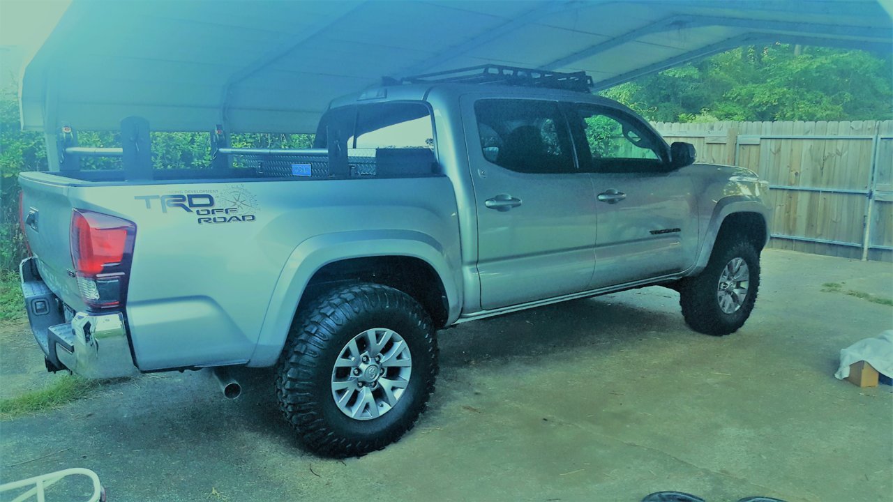

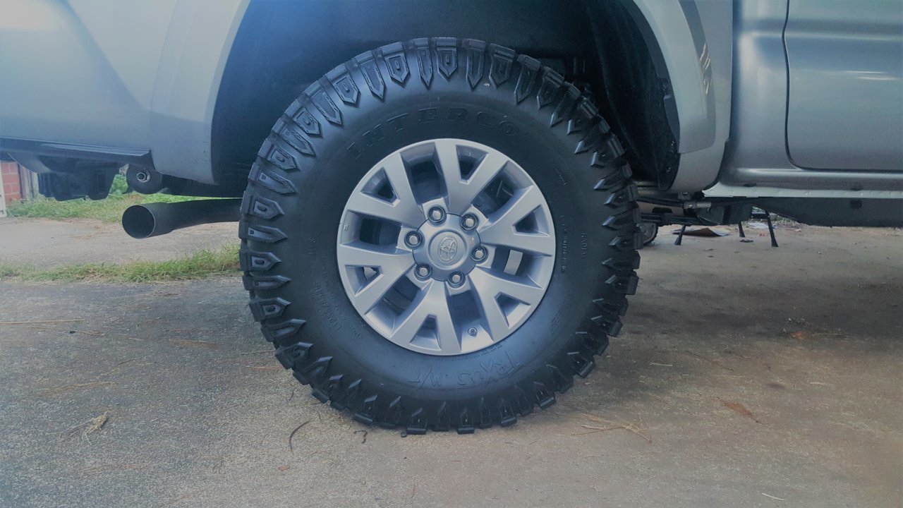

    I put Bilsteins adjustable shocks on my 2018 DC SB 4x4 and used OME coils and put 255/85/16s> 33s Trxus MT super swampers on SR5 Alloys The ride is so much better Bilsteins set at 2 in the front and Bilsteins in rear came out perfect at 2 inches of lift.
