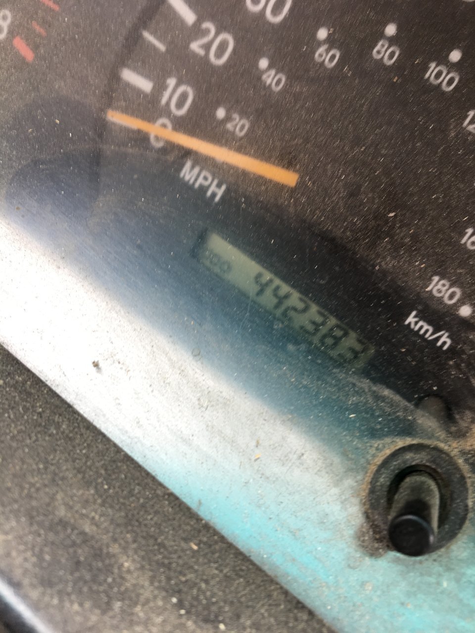

    Lots of members have more miles than my truck. @1997tacomav6 has 575k I think? And another member has 998k.
    The oil was sent out to be tested by Blackstone Laboratories. They send free test kits you can order from their site.

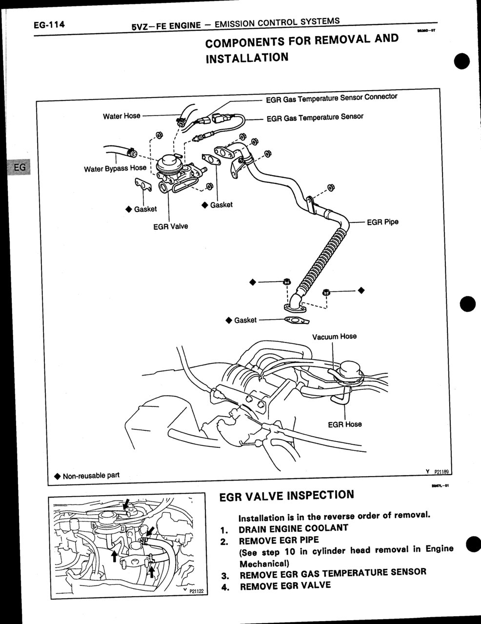

    Correction *EGR Pipe
    And now im looking at a it little closer, I definitely didn't ever remove or have any of those brackets that the diagram shows. hmmmmmm

    It keeps breaking you said? Have any pics?

    I have the EGR and never had an issue, its a steel pipe, how can it break?

    yep....
    the first time it broke, it took me forever to find where my exhaust leak was coming from, it would show up as I increased rpms and disappear at lower rpms. I found it cracked in the ribs on that pipe and it completely broke shortly after. im almost certain that I kept my last broken pipe, ill check and post back with pics.

    Have you tried changing or cleaning the EGR?

    Great question i've been trying to answer myself!
    mine broke in those ribs

    I still can't understand how that steel pipe can get a crack in it it just makes no sense maybe there's a possibility that there is defective EGR pipes in your area or a batch was made maybe you should order one from the other side of the country

    the valve? no I haven't, I didn't think of that causing a problem. I never had a check engine light until it broke, so I didn't think it needed to be cleaned, but I will try doing this and i'm gonna see how to test it in the FSM.
    Ill post the results, i'm also gonna call Toyota and see if I can find those brackets that hold it in place. Im starting to suspect that it could just be from the movement of the pipe without having those brackets.......i'm just really not wanting to buy a new one and have it break on me again but I need it for emissions in Colorado, or at least i need to figure out how to get the CEL to go away.
    It passes the emissions in CO by a mile so i'm not worried about it not passing the actual test without the EGR but its the CEL that will prevent them from 'passing me'

    I had thought that as well, but now those brackets are catching my eye.....
