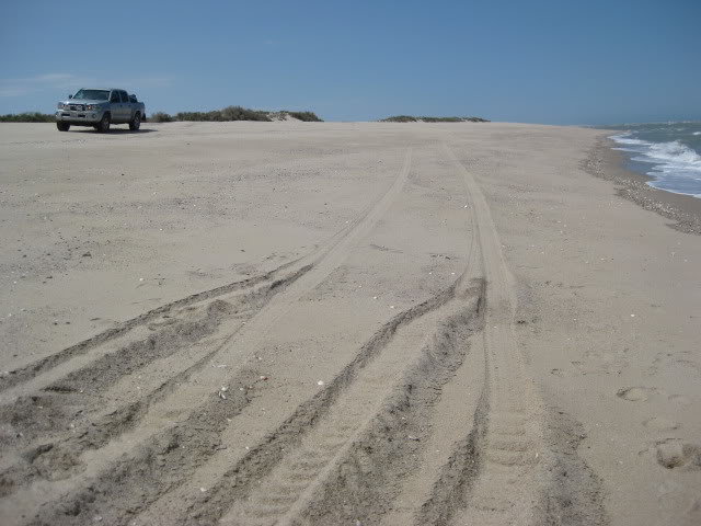

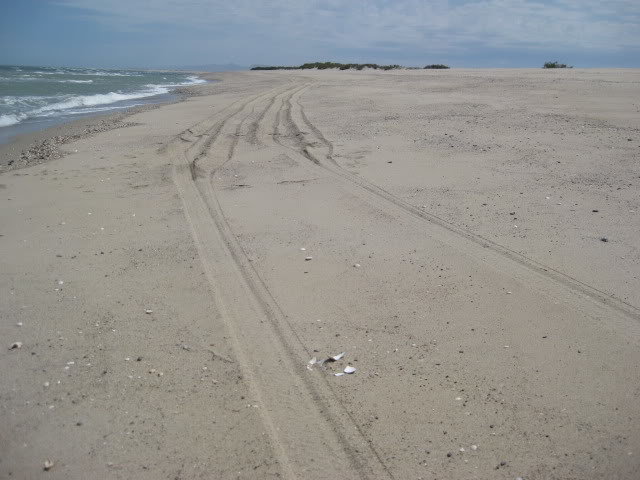

    Sand I don't worry so much about... it is clean and dry if you have to dig out (if you were dumb enough to spin the tires and get burried). MUD (water) is different... if you get stuck in there, you are in trouble!
    Deep sand driving is done more with air pressure than 4WD... It is less about traction and more about floatation.
    In this photo, I was in 4WD... the dug in tracks are at 32 psi (where I was struggling to keep from going into the water as the truck was slipping sideways down the steep beach). Then, after dropping the pressure to 15 psi, I floated out... with ease.
