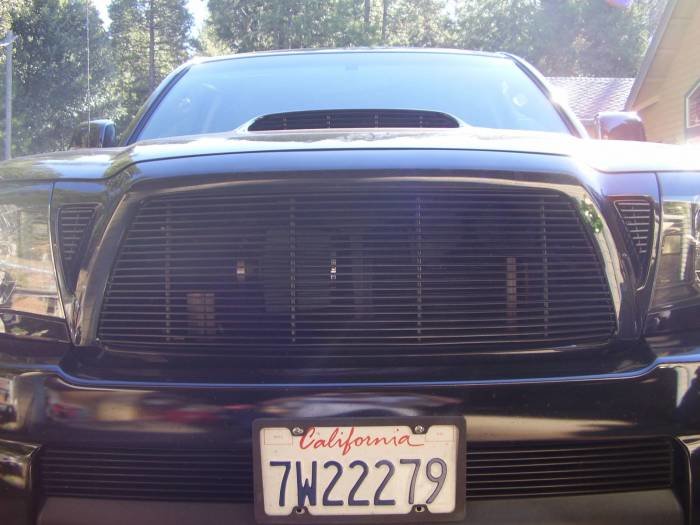

    I would powder coat it more durable for rock chips.

    I've seen a lot of chrome, but I like this black look. Would look cool with some copper highlights elsewhere.

    Looks great I need to do mine, clean it up its missing paint
