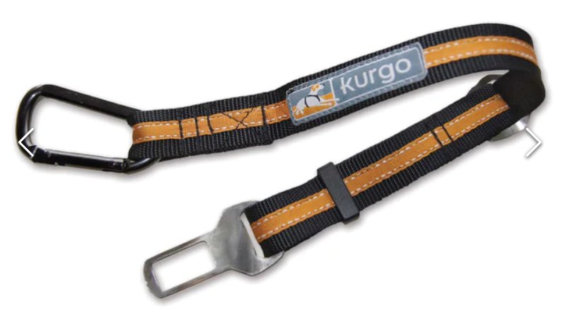

    I got one of these with my rescue pup.
    Does double duty for me, ... I frequently travel low-and-slow on back-roads looking for wildlife to shoot
    ... ( with my Nikon ha ha ) and hop in and out of the truck. Fking with the seatbelt means missed shots.
    So I plug this in and drive 10mph ...
    Plus if I ever need to take the pooch with me it doubles as a restrainer for the pup.
    I think any pet store or even Wmart sells these things, about $10-$15 bucks.
