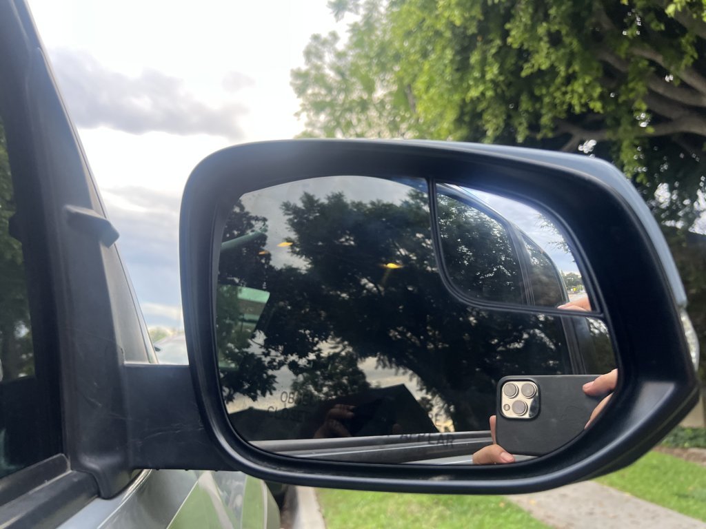

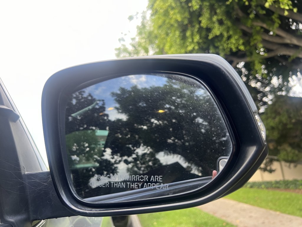

    I have a 2019 TRD Off-Road. They worked well and honestly I like them a lot more than blind spot monitors. It's a fit that I haven't found anywhere else

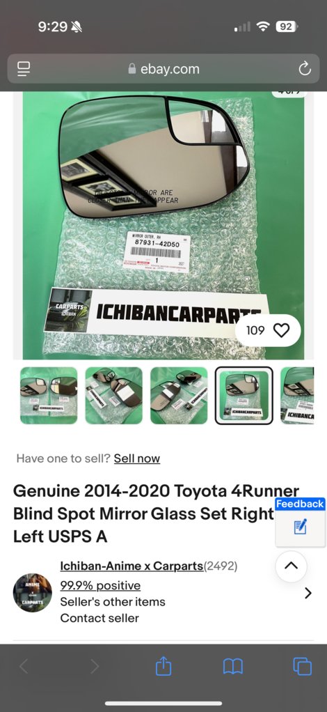

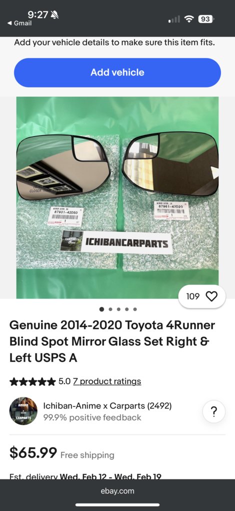

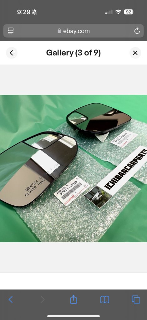

    this is the exact one I bought on eBay
    https://www.ebay.com/itm/385043378950

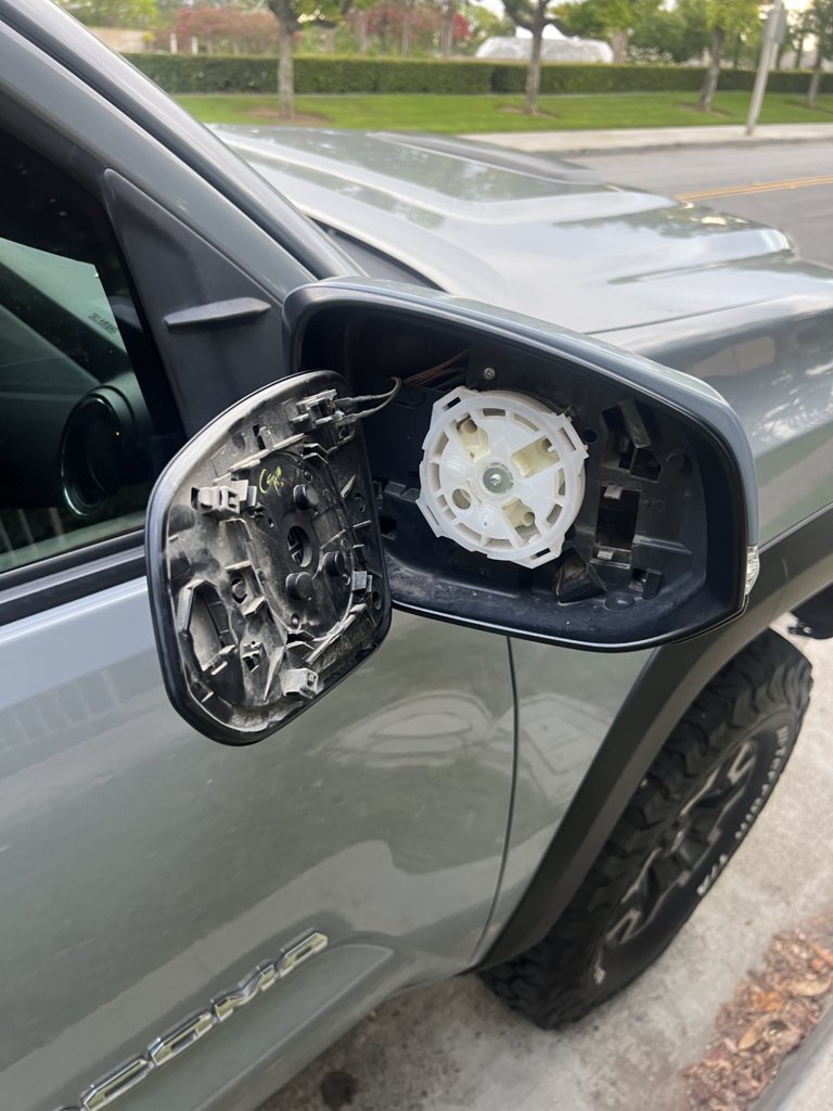

    I just used a plastic pry bar and popped it off disconnected these two cables and put it in the same spot on the other mirror to enable the heated mirror function. Pretty straight forward install
