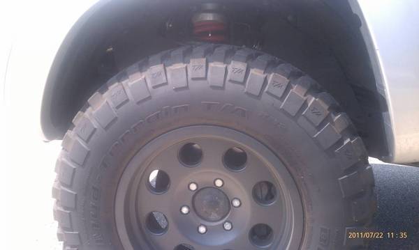

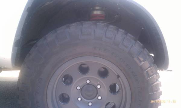

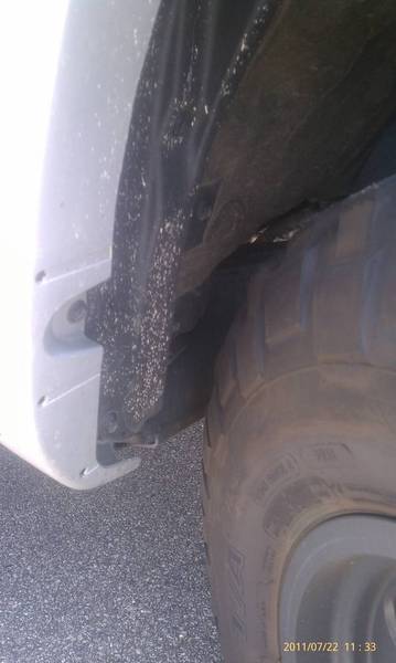

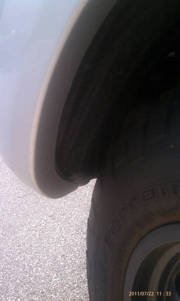

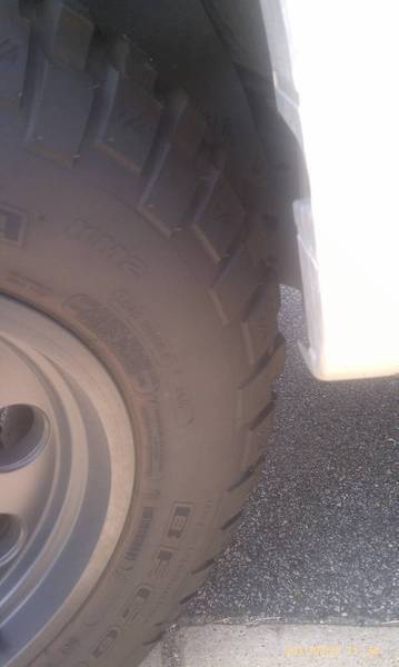

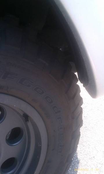

    Drivers side:
    Passenger:
    I've got the Toytec ULK, coilovers were adjusted slightly lower than stock to attempt to correct CV angles. I think I adjusted to 1/8" thread on the coilovers. I think that equals 1/4" less lift?
    The rims are atx mojaves 17x8 4.5"bs.
    I did have to trim on the front the small black plastic but it was barely touching.
    Sorry for the semi crappy pics. Cell phone camera + blinding sunlight = not great pics.

    Thanks for the pics John
    Did you get new UCA's when you did your lift ?
    I'm just wondering if I could adjust the caster to get the tire slightly more forward in the well .

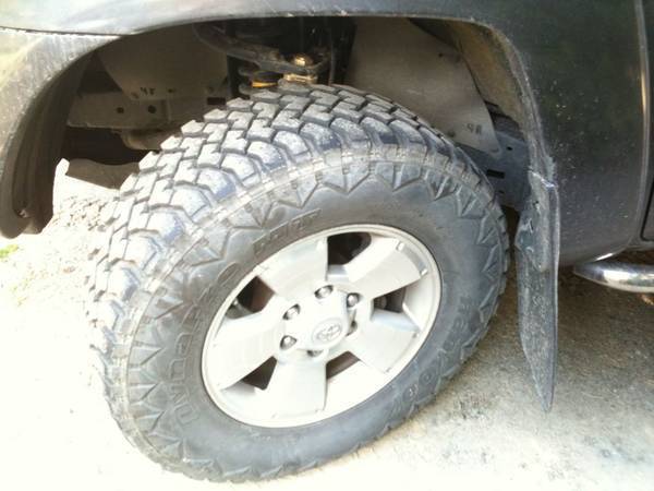

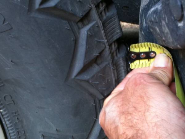

    My current 265/70/17 Hankook Dynapro M/T's are 31 1/2" tires , and as you can see I currently have only about 5/8" at the narrowest point with the wheel turned part way
    I'll be just touching with the 255/80/17 as they are a true 33" tire
    Wondering about heating and flattening or cutting the bump in the flap .
