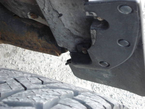

    I tried to heat n form my flaps today n it didn't work real well. I'm gonna hafta buy a new set n try again with proper tools

    I think TW member Fabulous cut the inner bump right off his , I'll have a look for a pic .

    From his gallery

    I may try that in the morning

    Might be worth a shot especially if they are messed up a bit by the heat gun

    Hey oz... I cut my flaps today to see how it would work. I left mine the full width(looks like fabulous narrowed his) and left about an inch stick up onto the body mount. I heated them and bent them backwards a little on the inner edge to keep em tight on the body mount. Took it for a ride this afternoon and no rub. Ill get a new set and do em right cause one side doesn't cover the body mount and has a big gap. Ill post pics when I get all that done.

    No rub. Had it twisted to bad today that the doors wouldn't close right. I travel a lot of dirt roads and spend a lot of time off road and don't wanna chip all the paint off my rockers

    I'd love to keep the flaps if it works

    Did you try cutting out the flap bump ?

    I had to cut the mudflaps and the front wheel well plastic to get 255/85 R16's to fit without rubbing. I have the stock wheels with spidertraxx spacers. KM2 tires

    Cut the flaps or lose them ?
