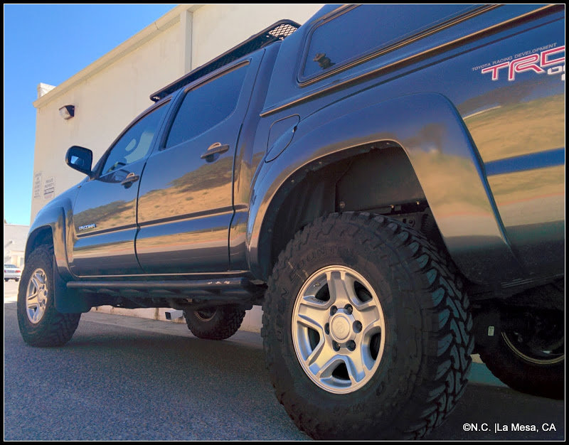

    Anyone have Cooper maxx 255/80/17s with the mud flaps on. I have Cooper ST 255/85/16s with the flaps on but the Maxx are a bit shorter and wider. Also 3" lift.

    I am running stock mudflaps with 255/85/R16 Toyo MT.
    I had to do a lot of modifications to make them fit without rubbing.

    So here is the deal. Not all 255/85/R16 tires are identical in dimensions. People who say that they fit without mods or minimal mods, aren't telling the whole truth, or are misinformed.
    I bought the Toyo MTS, and they are the tallest in their class. And I had to do every mod in the book to fit them without rubbing. I found out the hard way.
    I moved to 4Runner limited wheels with 4.5 BS to get off the UCA / LCA / Frame rub pain.
    But for OZ's question, yes, you can fit the stock mud flaps if you cut, trim, modify, etc. It can be done.
