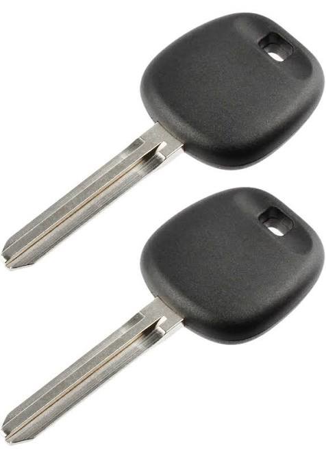

    The only valet key I have seen is one that will unlock the doors and start the vehicle, but will not work on the trunk or glove compartment. My 2005 Corrola had that, but then had a pull on the floor to open the trunk anyway!?!? The valet ket still had the chip so the vehicle would start.
    This key is what people have been using for the tailgate lock instead of carrying a regular key with push button start. It will not have a chip to start the vehicle.

    This is the key style that I was referring to... the difference between the regular key and the valet was the colour. Regulates black and valet was grey.
    shakerhood likes this.
