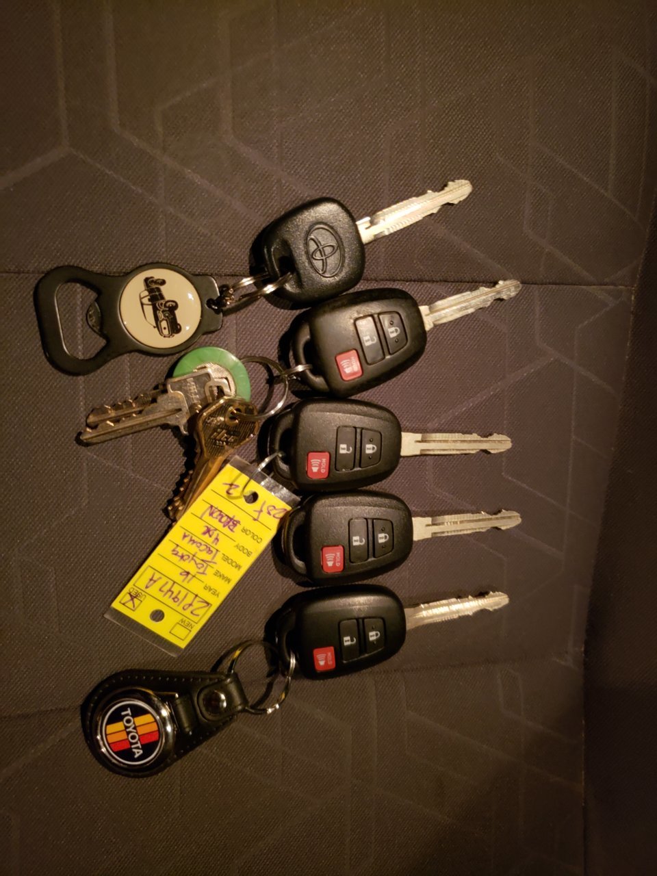

    Yes, you can have up to five H keys programmed. Whether they are a key, or a fobkey, or a mix of both. You can also have one valet(grey) key programmed as well. The plain key I have assigned to My 16 sport is pn 89785-0D140. The first and last fobkeys are the originals.

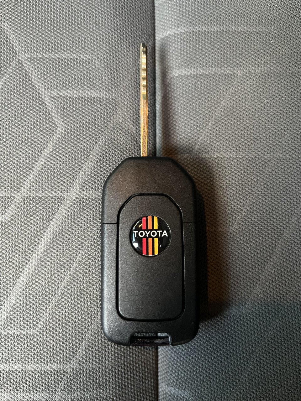

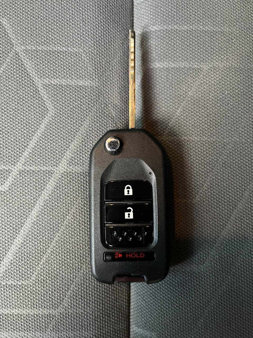

    ^^ All this. You can have a locksmith make you any style of key with this method. If they’re capable of it of course.
