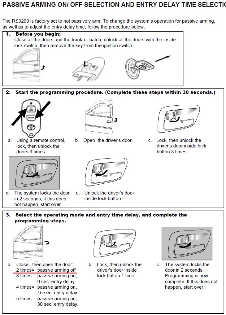

    Found this on another thread. Give it a shot.
    Here you go... It's on the Alldata site. I turned mine off, it was pretty annoying...
    As a convenience feature, the RS3OOO TVIP system is programmed to automatically lock all of the vehicle's doors (for vehicles equipped with power door locks) when the ignition key is turned to "ON" or "START", and unlock them when the key is turned back to "ACC" or "LOCK". The initial factory setting of this programmable feature is "ON". For some customers however, this feature is not desirable due to instances of passenger lockout when the driver enters the vehicle first and starts the ignition.
    AUTOMATIC (IGNITION-CONTROLLED) DOOR LOCKING/UNLOCKING FUNCTION
    The factory setting for the AUTOMATIC DOOR LOCKING/UNLOCkING FUNCTION is "ON".
    To change this feature's operation, follow the steps below:
    1.Sit in the driver's seat with driver's door open.
    2.Insert the key into the ignition switch, and turn it to 'ON" position (not "ACC") 5 times (ON > LOCK > ON > LOCK> ON > LOCK > ON> LOCK > ON) within a 10 second period.
    System Response: The STATUS MONITOR's LED turns on, and the PIEZO BUZZER sounds once.
