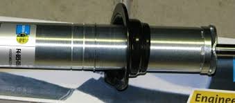

    You will be able to tell what setting they are on just by looking at your assembly. There are three stacked grooves, each groove is a different height setting. For 0 your should be on the very bottom one. If it is you will see the two "open grooves" above it on the shock shaft. You can see the grooves/ height set points in this pic.
