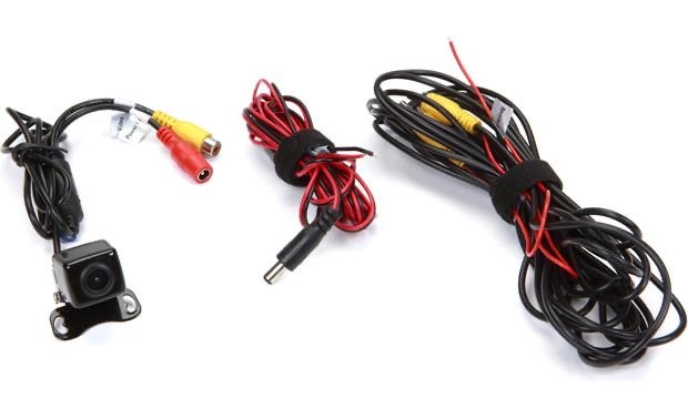

    Mine is very similar to that. You can see the yellow rca Jack and red power plug. The other bundles extend those wire to the HU and power source. Look to see if your camera has those plugs. You may still be able to relocate your existing camera if the wires have slack that was bundled behind the HU. If the connectors are too far away then a new camera might not solve the problem if the new camera wires aren’t any longer than the old ones.
